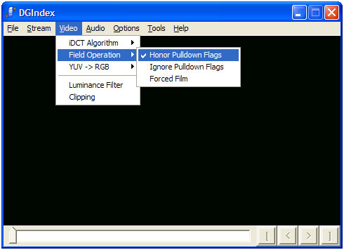

    As far as DGIndex goes you want to make sure you had the FIELD OPERATION set to HONOR PULLDOWN FLAGS. That's really the only setting I can think of that might cause a motion error and/or A/V sync error.

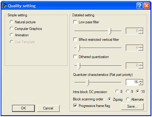

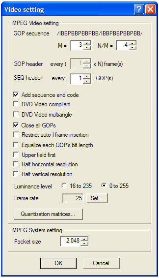

    As for CCE here is how I set mine up:
    Other than that it is setting the aspect ratio to 4:3 or 16:9 and the bitrate options etc.

    OK.. As for DGIndex.. I do recall you stated to set to HONOR PULLDOWN FLAGS.. but for the life of me, I searched every drop down menu for DGIndex and could not locate that setting.. But b/c you stated that it is likely default setting already, I didn't worry too much about it. Could I bother you to post a screen shot of that, please? Thanks!
    Here is a screen shot of DGIndex. This is using DGMPGDec version 1.4.6 which is the newest stable version. There is newer beta version but I haven't used it myself.

    CCE settings are a little different. For Video: I did NOT check Add Sequence Code or Close All GOP's. My Lum was 16-235, not 0-255. For Quality: I checked Natural Pic and Alternate vs. your Zigzag; 16x9 a/r. And bitrate was avg 6000, min 4000, max 9000. Original DVD was a D5, single layer... which leads me to another question, why does Bitrate Calculator no longer provide a minimum?
    Try to mimic my settings if you are having trouble although in this case the Lum setting makes no difference as that only affects RGB input (or at least not YUY2 input). Also Alternative is for interlaced sources and Zigzag is for progressive sources. As for your bitrate I would use a MIN of anywhere from 2000kbps up to but not more than 3000kbps ... the 9000kbps MAX should be fine as long as your audio has a bitrate of less than 500kbps or so which it should unless it is LPCM WAV audio.
    Let us know how it goes.
