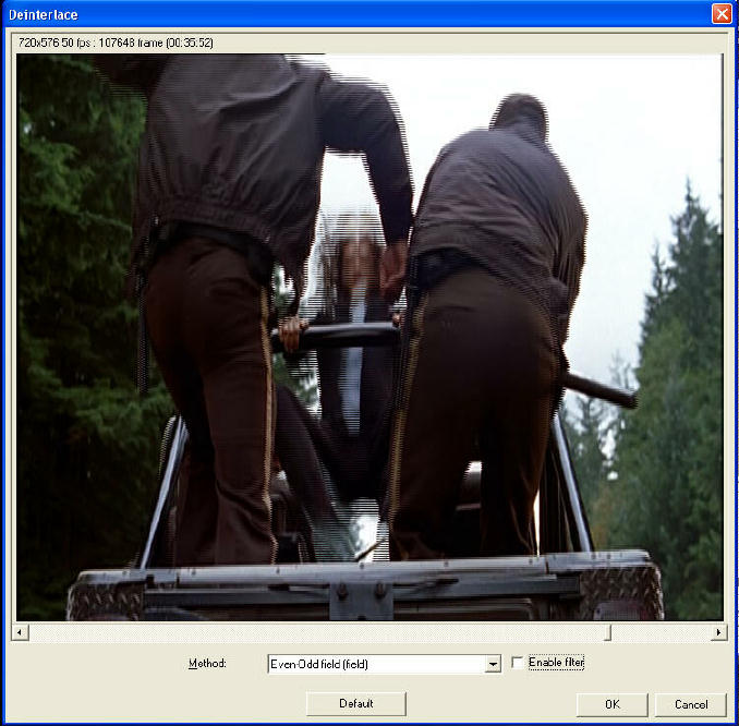

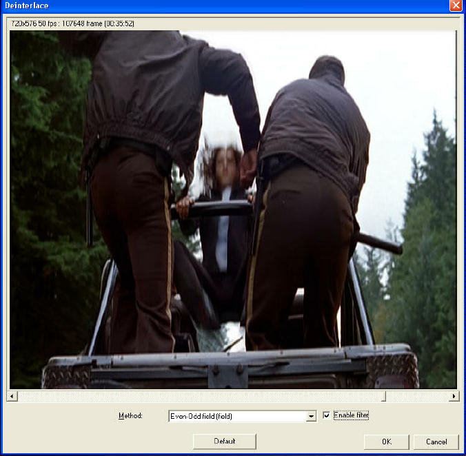

    Interlacing maybe ?
    I get rid of this in TMPGEnc by using the Deinterlacing filter.
    If this is the type of thing you are talking about, almost a jitter.

    No, the problem wasn't an interlacing problem. (at least I don't think so) It didn't have that "combing" problem shown in the example above, which I have encountered on other videos but I know how to fix that. My PAL to NTSC transfer looked beautiful, motion was perfect, the ONLY problem was what I call a "noisy jitter" visible when the movie itself is displaying anything with sharp horizontal lines, like the grill of a car, buildings in a cityscape, etc. These horizontal lines keep dancing up-down-up-down like they can't get on the right axis. I'd post a screenshot but it really wouldn't do any good, as you can't see the problem unless video is actually playing. I've seen this effect on some region-free players that can play PAL discs on NTSC tvs, so I'm sure it has something to do with going from 625 lines to 525 lines, rather than anything having to do with frame rate. As I said in my first post, I have a setting in my region-free JVC player that switches from "video" to "film" and gets rid of this problem if I'm watching a PAL disc on an NTSC set, but I don't know on a technical level exactly what this function is doing. Whatever it's doing is what I'm trying to get TMPGEnc to do.
