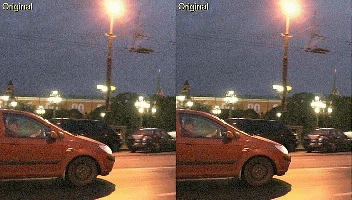

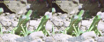

  22. The GIFs attached (I borrowed the original clips from the Neat Video page) show the "before" and "after" denoising with an AviSynth script.
    Believe it or not, Neat Video plugin can do even better.

  23. 1. What scrip?
    2. Why do all the pics have 'original' written on them? I see no 'after' or 'final'.
    3. Why dig up a 7-year old thread to try and demonstrate something for which we have to take your word?
  24. Originally Posted by manono View Post
    He started with the sample before/after videos at Neat Video:
    http://www.neatvideo.com/examples.html
  25. Thanks. I was expecting 'before' and 'after' or 'original' and 'final'. I've never looked at their examples (or had any desire to). I asked for the script to see which AviSynth denoiser he used, that he doesn't think does as good a job as NeatVideo. I'm not a believer in removing film grain. Although the examples aren't from films, I think it's often used to clean films.
  26. Originally Posted by manono View Post
    1. What scrip?
    1-This script (I didn't write it):

    2-I borrowed the clips and "original" was written on top of the "noised" one. I just denoised it and stacked it
    on the right.
