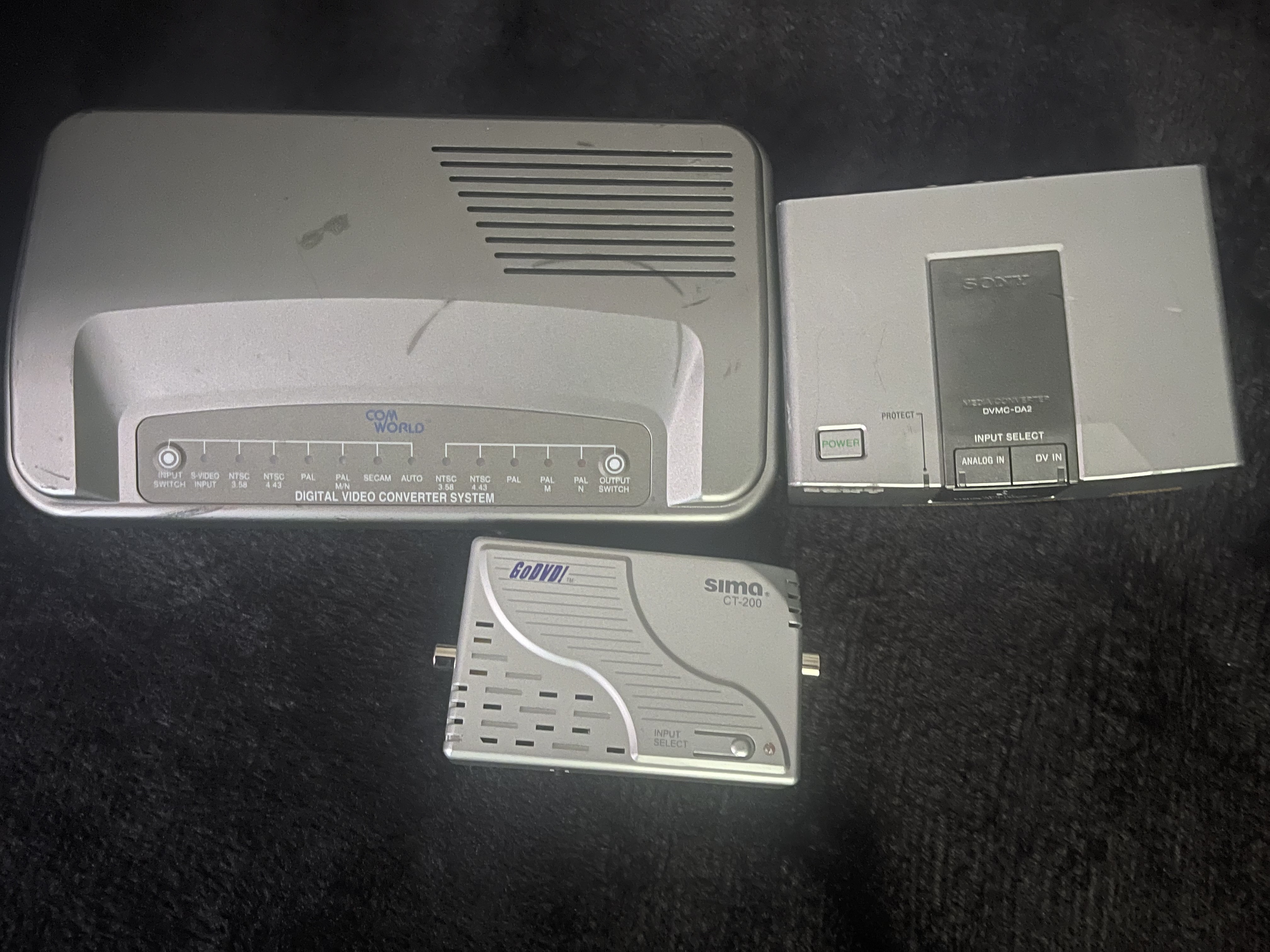

  1. I won an auction for it on eBay last week, and it arrived in the mail yesterday.
    Setting it up is a no-brainer:
    1. Plug power in
    2. Plug composite cables from VCR to DVMC-DA1 input
    3. Plug DV cable to PC firewire card from DVMC-DA1
    4. Turn unit on
    5. Run DV capture program
    That's it. That's all.
    I did a short test by capturing part of the ending action sequence from Aliens: Special Edition (it's the part right after where Ripley opens the airlock and the alien gets shot out). I figured converting to digital format (DV, MPEG-1/2, etc) from VHS tape is something lots of folks (me included) want to do.
    I pressed play on the VHS player, and clicked on capture in the DV capture program. After about a minute, I stopped the capture and pressed stop on the VHS player. Not too much work there.
    The DVMC-DA1 converts between analog and DV format. Once the capture was done, I encoded the video to MPEG-1 and MPEG-2 format using TMPGEnc v2.02 (free) and Vegas Video v3.0 (x-pensive). The results were inpressive! Sad (for them but great for most of us) to say, TMPGEnc held its own against the commercial Vegas Video when it came to the quality of the encoded files. BTW, I encoded using the VideoCD defaults in VV and the default VideoCD template in TMPGEnc.
    If anyone has any questions regarding this unit, feel free to ask. I will be doing more conversions from VHS and TV to DV format in the immediate future now that I have the DVMC-DA1.

  5. A quick update - the DVMC-DA1 can capture TV
    Here's my setup (each connection here is via coax cable):
    CABLE FROM WALL ---> VCR#1 ---> VCR#2 ---> WINTV PCI/FM
    I've connected the yellow, red, and white composite cables from VCR#2 to the DVMC-DA1. When I turn the unit on and run a DV capture program, I can capture the TV signal and convert straight to DV format.
    BTW, DVIO is a nice little DV capture program.

  7. Macrovision is basically an aberration in the video signal that causes copies to look like crap (in a nutshell).
    The SIMA CopyMaster strengthens and cleans the video signal from one video source to another.
    I'll let you do the math

  9. jtor: The Canopus converter looks good, and I believe it has one feature that the DVMC-DA1 doesn't - it can work with PAL video. I do not believe the DVMC-DA1 works with PAL video (please correct me if I'm mistaken!).
    The CopyMaster runs about $50 from Circuit City and the DVMC-DA1 was $200.
    It costs a bit of money for these, but the time saved was worth it.
    I chose not to go the USB Instant DVD route because I wanted to be able to edit the captured video,
    and MPEG compressed files do not lend themselves to easy editing.
