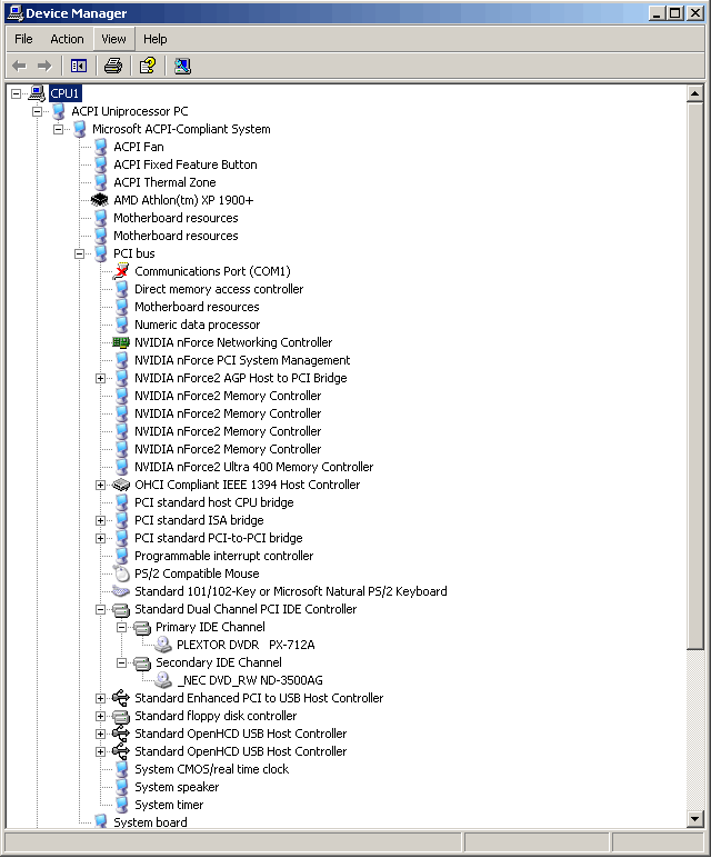

    If you are running Windows XP (not sure about other versions, probably would work in 2000), in Device Manager, open the View Menu -> View Devices by Connection
    Then expand the tree untill you find the IDE controllers, here is what mine looks like to give you an idea.
    http://img.photobucket.com/albums/v488/Skith/DevMngr.png
    Note: I pasted a link because the image's physical height (pixels) is rather large.
    Some people say dog is mans best friend. I say that man is dog's best slave... At least that is what my dogs think.

    View Devices by CONNECTION indeed!
    Thanks All
    Now I need to figgure out why the CONNECTIONS show my DVD drive on the opposite CONTROLLER from what the INTEL APPLICATION accaelerator shows!
    It appears from opening the box, the INTEL APP is wrong
