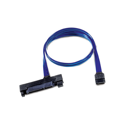

How true! Who invented this crappy connector? I would like to speak with them! The connectors don't even have a latching mechanism to keep them in place. At least not a good one! Cables are somewhat stiff too, compared to ATA. I've run across systems where the internal cables came unplugged by themselves, because of the crappy connector! I know one PC manufacturer that started putting some hot glue on the connectors to glue them down, so they wouldn't loosen during shipping. LOL!Originally Posted by redwudz
SATA Connectors on motherboards will vary depending on motherbaord and controller. But I agree, thay are flimsy. Some are good,m some are poor.
As for cables, you can get SATA cables now that have a lache on both ends and are also right angle too like this one:

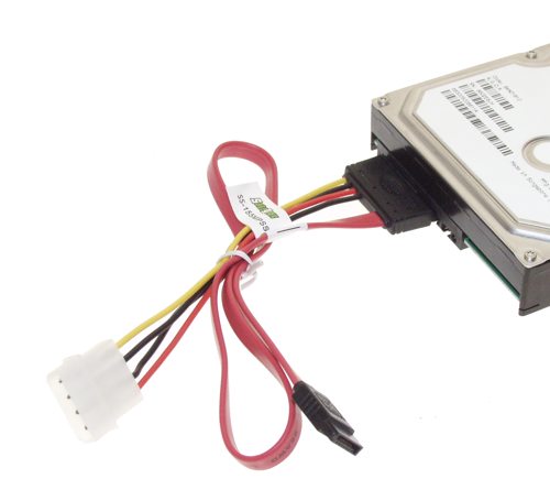

I saw another type of SATA connector that combined the SATA and power connectors on one plug and attached solidly to the drive. Can't find it now, but this one from http://www.cooldrives.com/seatacapoand.html is some improvement over the stock connector.
Redwudz, I think it may be the Western Digital SecureConnect you're talking about (and unfortunataly only for WD drives):
Thanks, waheed, that may be the one. It looks to be a better solution. I was curious how they manage the power to the drive, but looking at WD's site, it appears you would need to use the Molex ATA power receptacle on the drive. Your SATA power receptacle would be blocked by their connector.
I was thinking there was a move to power SATA drives over the same cable as the SATA interface uses. That would need a modified connector on the motherboard end for the MB to supply power instead of the PS doing it directly. SATA drives seem to use less power than PATA so it may be feasible. It would be nice to get rid of some extra wires, though.
Until then, the hot glue sounds like a good temporary solution, even using a connector like I posted. I've used hot glue before to hold a CD drive in a computer because it had an unusual rail system that had no stops to keep the drive from sliding back and forth. I just pried the hot glue off with a screwdriver if I had to pull the drive. Not really that bad.
