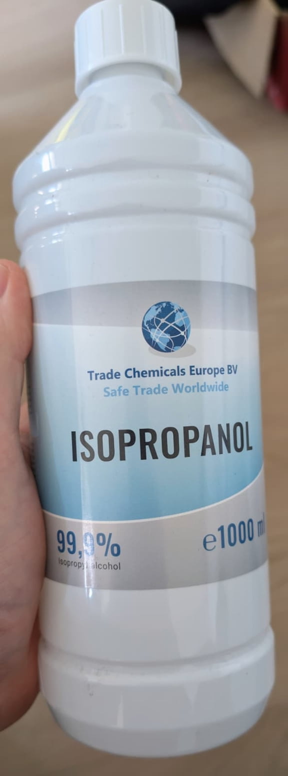

    Hi guys, quick question on cleaning video heads: what's wrong with using a strip of white printer paper + 99.9% IPA?

    Paper and IPA is useful for heavy contamination. I use it occasionally. However the paper is abrasive and when used on clean heads you can see that actual video head material is deposited on the paper (easy to see when its the green Panasonic heads). So people cleaning usual grey/black colour heads will keep seeing 'dirt' left on the paper when in fact its just video head material. I use in conjunction with a powerful loupe and point light source to see when heavy dirt is removed and I can work with softer less harsh cleaning methods and materials.
    Always rotate drum clockwise.
    Also paper and IPA does nothing to clean out the grooves on the drum. For that a fine plastic pick is needed. Plus loupe and light. You really need to look super close at the head to see the clumps of residue and work on them rather than just consider everything dirty. Residue builds on the drum directly around the head chip. This can be difficult to remove. IPA often doesn't touch it as it is tape lubrication build-up, not oxide.

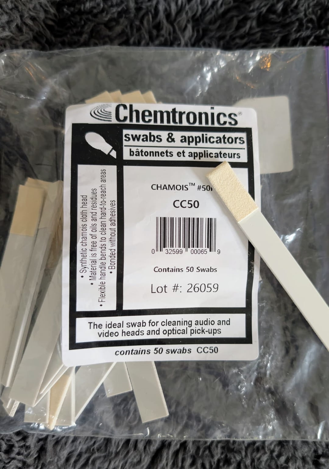

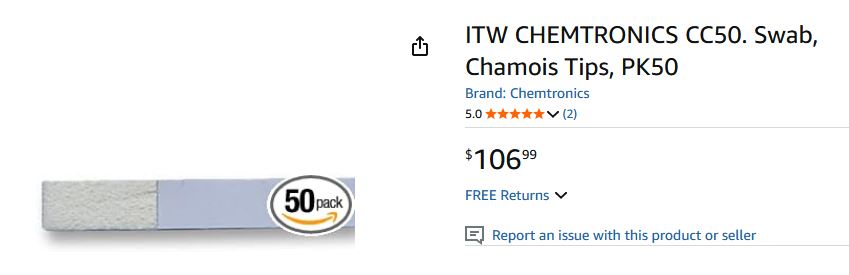

    Hi, thanks for the reply. It's this one:
    If I search for Chamois Swabs, I get crazy prices. Not saying I don't want to spend money, but that's ridiculous in my opinion.
    https://www.amazon.com/dp/B00GRM4XQ2
