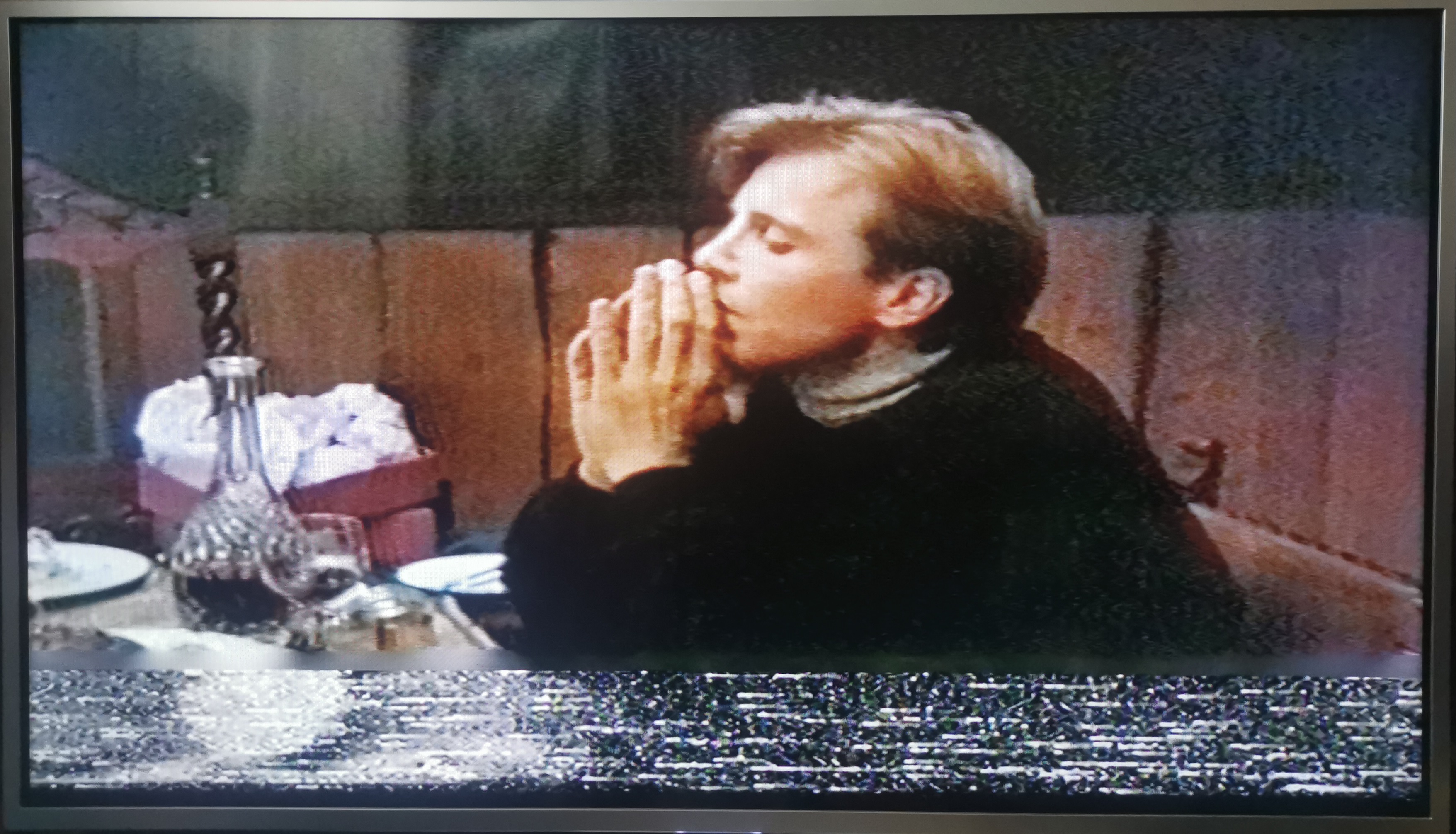

    Hello all VCR enthusiasts,
    Let me revive this thread...
    I am attaching the screen capture during playback.
    I think one or more video heads will not work.
    Because when I tried to clean the video heads, some stick out and some don't (I don't feel the resistance/thump when I run the paper over the video head).
    I assume that some video heads are already worn out a lot from long playback (they protrude very a little) and therefore do not have contact with the tape and the image is not visible in the lower part.
    Do you agree?
    Or is it possible that the problem is elsewhere?

  24. Member
    Aug 2007
    It certainly looks like a worn head. Do you have an old 50mm manual SLR lens kicking about? Using this (look from front to back with aperture wide open) with a small bright LED light such as an AAA one, you can visually check each head chip for larger damage and wear. By moving the light source and your viewing angles you can see the amount of flattening across the rounded head chip. Look at a known good head if you have one and you can soon distinguish a worn down head.
    But getting back to your picture this looks like a worn head sadly.
