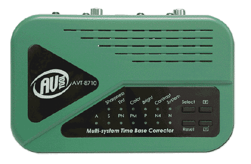

I have a JVC SR-V10U fed into a AVT-8710 TBC, then fed into a JVC DR-M100S.
It's a wonderful setup.

Where would the AVT-8710 that I'm going to buy go?Originally Posted by lordsmurf
I prefer
JVC S-VHS > ES10 > AVT-8170 > JVC DR-M10
From testing, that is the most effective.
If you add a proc amp or detailer, put them between the 8710 and the DVD recorder in any order.
Just be sure you can easily get to the s-video cables to unplug with ES10 when its services are not required (which should be at least half of the time, if not more .... depends on your source quality). Same for proc amps and detailers, should you ever get any.Want my help? Ask here! (not via PM!)
I have to get those too? The AVT-8710 has Sharpness/Tint/Color/Brightness/Contrast controls. Won't that do the same job?Originally Posted by lordsmurf
You don't have to get anything. But the AVT-8710 extras are a far cry from a BVP-4 or a DR-1000. It just depends on your needs.
The setup you've proposed so far already sounds excellent.Want my help? Ask here! (not via PM!)
