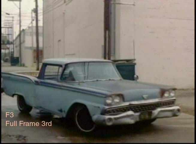

If you step frame by frame through the video and see frames like these in a repeating pattern, then the source is film.
