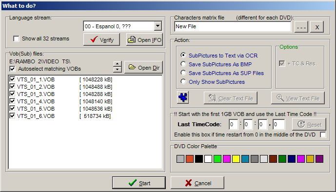

Step 3) It's time to pull the subtitle off the existing VOBs you ripped to HD earlier. Run Subrip, click on the VOB button in upper left, and open the IFO file in the VIDEO_TS subdir. That'll pull up all the VOBs and their subtitles/closed captions. You can pretty much leave all the
other settings alone, and just go OK.
If you need help using SubRip, please refer to this guide:
https://forum.videohelp.com/viewtopic.php?t=267416
The result will be an .SRT file with Spanish subtitles in my test case.

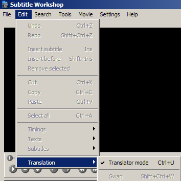

Step 4) Open up Subtitle Workshop, and enable Translator Mode,
Load subtitle1 (the language wanted) into "original" and subtitle2 (the language you ripped / wrong language) into "translated".

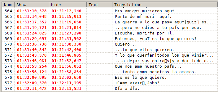

Step 5) Jump to very end of the list. You should see a bunch of blank lines, but with matching stuff on the translated side, and vice versa. The two subtitles don't "sync". We need to "sync" the content first, THEN we can borrow the timing.
Your ripped file has different number of entries than the file you downloaded. In this case, the ripped entry has 578 lines, while the downloaded version has only 422 lines. So you will have to do some serious line splitting to do.

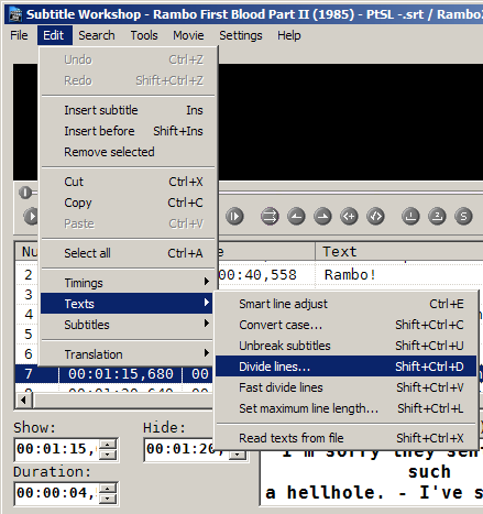

You notice that the Spanish side only has Trautman's line, but the English side has both Trautman and Rambo. So you need to split the English line into 2 lines, so the 2 sides can match.
So do Edit / Texts / Divide Lines (or just use the keyboard shortcut)

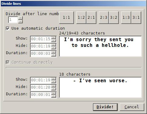

and you get the Divide Lines dialog.
Make your division here, and voila you get 2 lines instead of 1! But now the two sides don't quite match, as you get an extra blank line on the translated side. (It's in red)

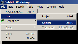

However, that's easy to fix. Just do File / Load / Translated, and reload subtitle2 (the "wrong" file). It'll prompt you to save both, but only save the one you're actually WORKING on (subtitle1). Do NOT save subtitle2! When load complete, your 2 lines will be in sync, the blank line gone. However, there's plenty more to go.

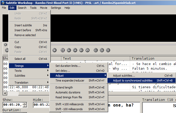

Do Edit / Timings / Adjust / Adjust to Synchronized subtitles. You just replaced all of your timing with proper timing from that other set you ripped (and thus, correct).
Or you can use the keyboard shortcut.
Now try to preview again, from the very beginning... Voila! Perfectly sync'ed subtitles!
