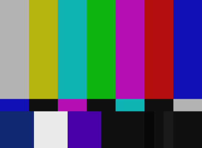

Does your computer have s-video or compostite outputs? If so, hook that up to a TV and calibrate the computer output with a colorchecker image.Originally Posted by swiego
