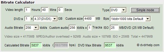

First you need to decide your audio format and bitrate for the audio. In my example I will use 256kbps AC-3 audio as that is generally considered the "sweet spot" bitrate wise for 2 channel Stereo/Mono audio.
Now you need to know the running time. In my example let us say the movie is 100 minutes long.
We now go to a MPEG-2 DVD bitrate calculator.
Here is one we can use that works well ---> CLICK HERE
Here is what the bitrate calculator looks like:
The calculated bitrate for the video in this example is 5837kbps if you are using 256kbps for the audio (the audio can be MP2 or AC-3 because either format will be the same file size at the same bitrate ... the difference is AC-3 at 256kbps will sound better than MP2 at 256kbps due to AC-3 being a superior audio compression format).
If you are doing a CBR (Constant Bitrate) encode you would use 5837kbps. If you are doing a 2-pass or mult-ipass VBR (Variable Bitrate) encode then 5837kbps is your AVERAGE bitrate. The bitrate calculator suggests a MAX bitrate of 9537kbps for the video but in my experience the MAX should be set at 8000kbps when using MP2 or AC-3 audio. 8000kbps is probably also ok if using PCM WAV audio but to "be safe" I prefer to use a MAX video bitrate of 7500kbps when using PCM WAV audio. Please note that MP2 and AC-3 can have various audio bitrates up to 384kbps for MP2 and up to 448kbps for AC-3 whereas PCM WAV audio has a "fixed" bitrate of 1536kbps.

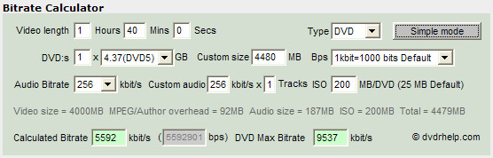

One has to be carefull not to make the file size too large though because we need room left over for the DVD authoring stage. I have found that changing the ISO from 25MB to 200MB will leave enough room in just about all cases.
So let us return to my original example except this time I'm changing the ISO size from 25MB to 200MB:
The video bitrate has dropped from 5837kbps to 5592kbps thus creating a file size that is 175MB less in size since I used 200MB instead of 25MB for the ISO size (200 - 25 = 175)
