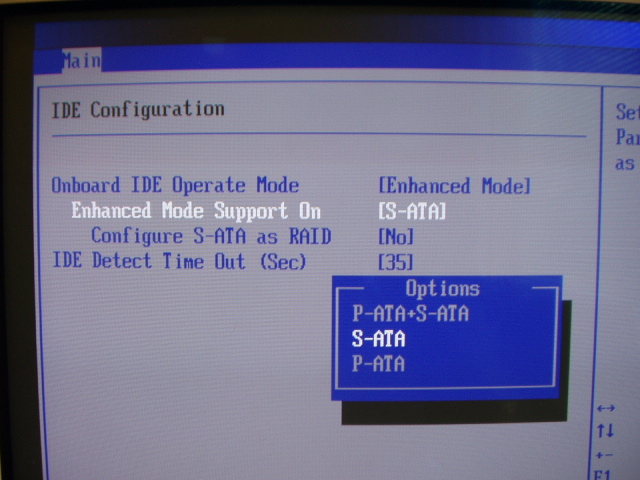

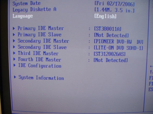

I've had a look through the user guide (copy here - it's 5Mb), and think (read as "hope") that it might be possible, because there's a section (4.3.5 on page 75 of 125) that talks about Primary and Secondary IDE Master / Slave and Third and Fourth IDE Master.Originally Posted by solarfox
Also, the cabling inside has one larger connector (top pic) available (the wide one with two rows of holes for the pins) and one smaller connector (bottom pic) available (it's much smaller than the other one). Similar connectors are already in use for the HDD and DVD drives.
These BIOS pics may be of use:
I've tried hunting around the Asus site: FAQs, mobo specs, forums etc. but couldn't find anything.
Comments? Thoughts?

you may have to change the IDE config. to P-ATA+S-ATA
pop in the new drive. You still have room for 2 more devices.

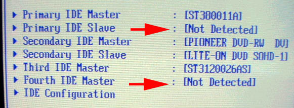

P.S. by the way, in the two pic's you have, the upper pic (the large connection) is the IDE and the lower pic is the SATA connection. You already used up one of your SATA connection for your HD (the third IDE master. Your 120Gig Seagate) You still have 1 IDE slave and a SATA master free. Depend on what kind of drive your new 250Gig is, you can connect it to the primary slave if it is an IDE drive or if it is a SATA drive then connect it to the fourth IDE master (which is a SATA connection) -
Your ST3120026AS hard drive is SATA, in the Third IDE Master position, so you should have a spare PATA (IDE) connector in the IDE Primary Slave position. The other HD is a PATA ATA100 in the Primary IDE Master position. The fourth IDE Master is probably a empty SATA connector, so you should have one of both types available. You should be in good shape as long as you have mounting room for the drive(s)

Well, the new 250Gb IDE HDD is all hooked up and working like a charm. No need for PCI cards etc. - there was (as was suspected) spare capacity on the mobo.
Thanks to all for your help.
