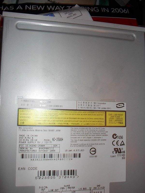

Originally Posted by Bjsi looked into firmware flash my drive, but im not shore what brand my burner is. here is a pic of the back of my burnerOriginally Posted by redwudz
i looked at this http://forum.rpc-1.com/dl_all.php#G but what should i download for my burner? ive never done this before so im nervous i might mess up my burner by installing the wrong thing -

You apparently have a NEC ND-3500A. If that's correct, this page has the proper firmware. http://forum.rpc-1.com/dl_firmware.php?download_id=1904. As mentioned, you need to know your present firmware version if you want to upgrade the firmware.
BUT the NEC ND-3500A is a 16X burner
Your media may be the problem then. Upgrading the firmware might not help you, but look around at some of the firmware sites and see what they say.Format: DVD±RW, Enclosure Type: Internal, Interface Type: E-IDE, Read Speed: 48x (CD) / 16x (DVD), Write Speed: 48x (CD) / 16x (DVD-R) / 16x (DVD+R) / 4x (DVD+R DL)

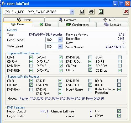

ok heres my drive info. what should i download?Originally Posted by redwudz
The latest official firmware from NEC is 2.1A
you can dl on the following page:
http://forum.rpc1.org/dl_firmware.php?download_id=1904
you will see the following, you want the underlined file .
the filename is: NECND350_v21A.exeNEC DVD_RW ND-3500AG - 2.16, 2.18, 2.19, 2.1ASome people say dog is mans best friend. I say that man is dog's best slave... At least that is what my dogs think. -
