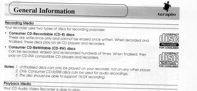

    I've owned 3 of the dam*ed things - there was a caveat on their website regarding using "consumer" CD-Rs and CD-RWs, it even says so in the manual. Research "consumer CD-R and CD-RW".

    I know the Terapins would burn on data CDs - the manufacturer would ask if the only media used was audio CDs when the drive failed...which they did. Terapin would blame the failure on using the wrong media.
    The drives were crap on them, anyway - It amazed me the difference between the Terapin and the first Panasonic E-20 that I bought (and still use). The Panny is built like a tank, the Terapin was a MIS piece of crap.
