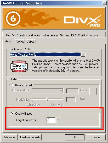

If you care about quality, not file size, use Constant Quality encoding. That way you'll always have exactly the right bitrate for the quality you want.
At a setting of 2 there will be virtually no difference between the input and output, even if you look at enlarged still frames. At three you will see a little macroblocking if you look at enlarged still frames but not at normal playback speed. The higher the value the lower the quality and the smaller the file. -

Try a constant quality encode and then look at the average bitrate of the resulting file. That will tell you what bitrate is needed to get the quality you want with any particular video. If you perform a constant quality encoding, and then use that average bitrate for a 2-pass VBR encoding the results will be nearly identical. -
even as far as stuff like dvd ripping from commercial dvd's........still requires a bit of tinkering to figure out exactly what would work best........probably best to just stick with the quality based setting in divx for about as close as you can get to a "surefire" way to retain quality......
