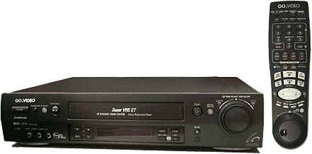

    ALSO don't forget GoVideo SDV-650, a "re-branded" JVC HR-S9800U. There is someone selling 2 "new old stock" of those right now on Ebay. That's another unfamiliar model number that few might search for.
    JVC SR-V10U:
    GoVideo SDV-650:
