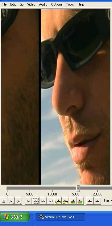

    I have an MPEG-2 file that is really out of wack. The two sides of the frame need to be swapped. The alignment never changes and it last the duration of the video. Audio is fine. I have searched hard for a VirtualDub filter that could possibly do it. To no avail. Do you know of any other programs that can fix this issue?
    Much appreciated.
    Still frame of image (look at logo on sunglasses for alignment)

    AVISynth and the stackhorizontal() and crop methods might be able to fix this:
    https://www.videohelp.com/forum/userguides/99389.php#crop
    If in doubt, Google it.
    You mean stackvertical()?

    No, I believe I mean stackhorizontal so they're side by side

    Every time I try to open my .avs file in "mplayer2" or VirtualDub, it just shuts down the app. Here is my avisynth code.
    DirectShowSource("C:\video.mpg", fps=25.00)
    h1=crop(0,0,176,576)
    h2=crop(176,0,176,576)
    StackHorizontal(h2,h1)
