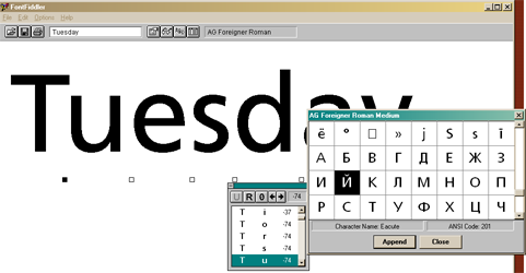

 Also, this site : http://screenfont.ca/fonts/today/interim/ has some very interesting comments and suggestions for fonts.
 The link you gave for AG-Foreigner-Roman is dead, and Google doesn't give anything useful.
 I'd want a font that had an italic style, so the software didn't have to fake it. I've used Lucida Fax and Verdana mostly.
 PS: As for spelling, you might check your/you're. You have several mixups.

 Now I've seen it, it's not a freeware font, but it obviously is floating around, designed by Andrejs Grinbergs (thus the AG). It's actually a Cyrillic (Russian alphabet) version of the font more often named Frutiger.
 see, eg http://www.paratype.com/fstore/default.asp?fcode=175&letter=F
 If you have any Corel products, you probably have the Bitstream version, Humanist 777.
 Anyway, the point is that because it has Cyrillic characters in the "upper ASCII" positions, you have to be careful if you use, eg, any accented characters, you'll get Russian instead.
