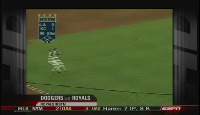

This is a 480i frame inside a 720p frame but illustrates the issue. 29.97 fps interlace by definition starts with half the vertical resolution during motion.

I know it is a poor example but illustrates the way interlace handles motion. I'm planning to get more examples off the Olympics coverage.Originally Posted by MozartManRecommends: Kiva.org - Loans that change lives.
