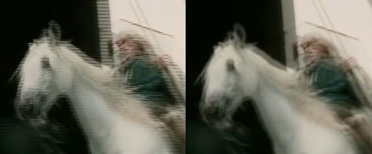

    Capture something and use VirtualDub to single step through the frames where something is moving. If you see interlace comb lines it's interlaced. Blend deinterlacing will often look like a double exposure.
    On the left is a crop with interlace, on the right with a blend deinterlace.
