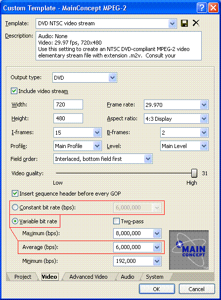

    when you set your bitrate, you need to set it here.
  15. Member crazy14muzic's Avatar
    Jan 2005
    USA Missouri
    you can use either constant bit rate or the variable bit rate settings but dont mess with the system tab settings

    if you use the vbr setting use the average bps one. the cbr one self explanatory but for any instance anytime that a bitrate calculator gives you a four digit KBPS number you need to add 3 zeros to it
    you can input any number you wish just make sure that it is 7 digit in this instance
