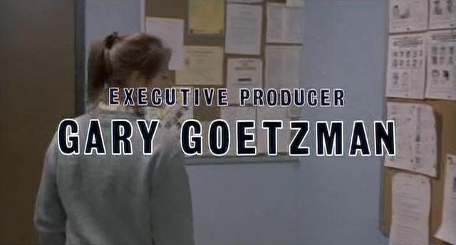

Now, after many hard attempts to remove some worst artifacts from the video, I finally dwelled upon RemoveGrain filter. I made trials with this filter like any other filters that I had been trying out since the past few days, and expected nothing great. However, miracles happen without our knowlegde, isn't it. And it happened to me with RemoveGrain(). After the usage of a long list of filters(which include - Convolution3d, fft3dfilter, NoMoSmooth, WarpSharp, Dust filters), I found the difference which I actually had been expecting, through the RemovGrain() Filter.
So, here's my modified script:
Script 1
Capture 1 (Using RemoveGrain() Filter):Code:LoadPlugin("d:\programs\dgindex\dgdecode.dll") LoadPlugin("d:\program files\avisynth 2.5\plugins\DeComb.dll") LoadPlugin("d:\program files\avisynth 2.5\plugins\LoadPluginEX.dll") LoadPlugin("d:\program files\avisynth 2.5\plugins\RemoveGrain.dll") LoadPlugin("d:\program files\avisynth 2.5\plugins\warpsharp.dll") LoadPlugin("d:\program files\avisynth 2.5\plugins\masktools.dll") import("d:\program files\avisynth 2.5\plugins\LimitedSharpen.avs") mpeg2source("e:\sol\sol.d2v") Telecide(order=1,post=0,guide=1).Decimate(cycle=5,mode=0) ConvertToYV12() RemoveGrain(mode=17).RemoveGrain(mode=17).RemoveGrain(mode=17).RemoveGrain(mode=17) RemoveGrain(mode=17).RemoveGrain(mode=17).RemoveGrain(mode=17).RemoveGrain(mode=17) limitedsharpen(ss_x=1.0,ss_y=1.0,smode=3,dest_x=640,dest_y=344,strength=40) Crop(4,14,-8,-14) LancZosResize(640,344)
Now, without using the filter, the script & corresponding capture are here:
Script 2
Capture 2 (Without using RemoveGrain() Filter):Code:LoadPlugin("d:\programs\dgindex\dgdecode.dll") LoadPlugin("d:\program files\avisynth 2.5\plugins\DeComb.dll") LoadPlugin("d:\program files\avisynth 2.5\plugins\warpsharp.dll") LoadPlugin("d:\program files\avisynth 2.5\plugins\masktools.dll") import("d:\program files\avisynth 2.5\plugins\LimitedSharpen.avs") mpeg2source("e:\sol\sol.d2v") Telecide(order=1,post=0,guide=1).Decimate(cycle=5,mode=0) limitedsharpen(ss_x=1.0,ss_y=1.0,smode=3,dest_x=640,dest_y=344,strength=40) Crop(4,14,-8,-14) LancZosResize(640,344)
I posted this particular frame only, as it best describes the vast difference between the using and not using RemoveGrain filter. I hope even you are noticing the difference.
I'm quite satisfied with whatever I acheived through these filters. Any further ideas to enhance the quality of image are widely accepted. -

I got the 2 pics and ran a Windows Slide Show with them. A couple of things jumped out at me. One was that the white outlines around the credits writing got washed out, especially the upper line. The other is that the writing on the papers on the wall on the right side is blurrier after being filtered. Maybe too many RemoveGrains. Anyway, I think you're on the right track, and if it looks much improved to you, then that's the main thing. Good going. -
I also notice a loss of detail but I do like the "smoothness" of the image.

Anyways, I came across another filter which I didn't notice before - eDeen(). May be, some of you knew it before. This filter did a great job in denoising. I guess it's equivalent to a 100 RemoveGrain() filters in series.
I bet, it's the best and strongest denoiser, I've ever seen.
Let me show you the modified script:
Here are the PNG captures for the above script:Code:LoadPlugin("d:\programs\dgindex\dgdecode.dll") LoadPlugin("d:\program files\avisynth 2.5\plugins\DeComb.dll") LoadPlugin("d:\program files\avisynth 2.5\plugins\warpsharp.dll") LoadPlugin("d:\program files\avisynth 2.5\plugins\masktools.dll") LoadPlugin("d:\program files\avisynth 2.5\plugins\eDeen.dll") import("d:\program files\avisynth 2.5\plugins\LimitedSharpen.avs") mpeg2source("e:\sol\sol.d2v") Telecide(order=1,post=0,guide=1).Decimate(cycle=5,mode=0) edeen(7,14,21,2,3,true) Crop(4,14,-8,-14) LancZosResize(640,344) limitedsharpen(ss_x=1.0,ss_y=1.0,smode=3,dest_x=640,dest_y=344,strength=0)
Cap1
Cap2
Cap3
Cap4
These caps can be compared to the original video. Here is the script containing the raw unfiltered video and the corresponding PNG captures:
And the PNG captures for the above script are:Code:LoadPlugin("d:\programs\dgindex\dgdecode.dll") mpeg2source("e:\sol\sol.d2v")
Cap1
Cap2
Cap3
Cap4
Since eDeen() is an extremely strong denoiser, I can't apply it more than once. If applied, it removes huge amount of detail from the image leaving with completely detail-less images. The faces appear color bleeded.
However, after the application of the strongest denoiser like eDeen() and a moderate sharpener like LimitedSharpen(), I'm still not able to completely improve the image quality as you can see in the above captures. So, please suggest anything good. -

Anyways the reason I bring it up is that those pics look overly done. There is too much of a loss of detail. You need to back off a bit I think.
Jodie Foster's face (see cap 3 for instance) looks all "pasty" in the eDean capture. It's too smoothed out ... there is so much detail lost it gets a strange "pasty" cartoon look if you will.
So maybe play around a bit with the eDean numbers so it is not so over done.
Even I don't have enough time or energy to read about eDeen. I just used the default settings. May be I'll continue with RemoveGrain. It atleast has some limits. If not, I'll use only fft3dfilter with the previously decided settings i.e.,Originally Posted by FulciLives
