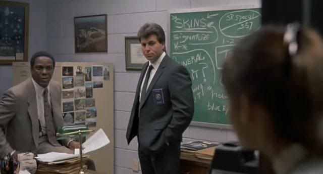

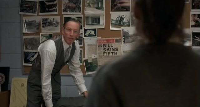

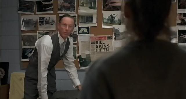

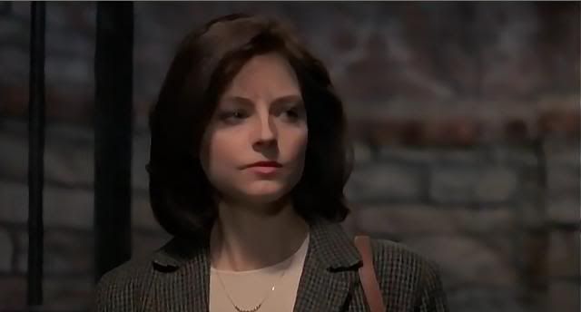

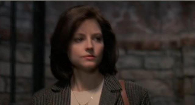

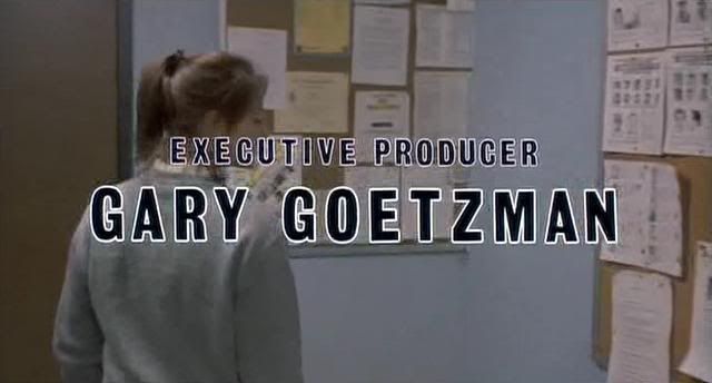

    I saved the .d2v project of my movie "The Silence of the Lambs" at 23.976 forced film frame rate. The following script is used to open the project in VDubMod:
    LoadPlugin("d:\program files\avisynth 2.5\plugins\TomsMoComp.dll")
    mpeg2source("e:\sol\sol.d2v")
    TomsMoComp(1,5,1)
    Crop(4,14,-8,-14)
    LancZosResize(640,344)
    Although I applied the deinterlacing filter(TomsMoComp.dll), I still found a lot of artifacts in the movie which need some other suitable filters for removal. I don't have much knowlegde on the AVISynth Filters and plugins. So, I'm posting the caps taken from VDubMod. Please suggest the suitable filters to remove the artifacts present in the pictures below:
    Cap1
    Cap2
    Cap3
    Cap4
    Cap5
    As far as I noticed, there is a lot of ghostness present in the film, the faces are not clear and blurred a lot. Please suggest the suitable AVISynth filters/plugins to remove these artifacts.

    I would say that this is probably from too much filtering. Looks like
    you've been using some smoother or similar, way too much. And this
    could result in artifacts as those in your pics, mixed with deinterlace
    filters or other filters in your script.
    I would suggest that you bypass any filters, and re-run the demos' to
    reproduce the same pics above (use the same frame number) and repost
    the results. Might turn out positive this time.

    Reminder: The captures are not taken using VDubMod's tools(like Snapshot output Frame -> Shift-2 or Snapshot Source Frame -> Shift-1), but they were taken by just using the 'Print Screen' key on my keyboard when VDubMod is showing the preview of whatever script is being loaded. Then I copied the screenshot in Microsoft Paint, re-edited the screenshot such that only the film shown by VDubMod is cut out.
    Coming to the usage of filters, the only filter I used for enhancement is TomsMoComp filter throughout the AVISynth script. Since, you're suggesting me to show the results before using filters,
    Let us see the results before using this filter:
    Script1:
    Crop(4,14,-8,-14)
    As you could clearly see, nothing is done to enhance image quality. I just borrowed the source from a .d2v project, cropped and resized it. So, practically, I didn't use any filters.
    Now, watch the screen capture of a particular frame when the above script is loaded into VDubMod:
    Capture1
    Now, after using the TomsMoComp Filter as shown in the script below:
    Script2:
    TomsMoComp(1,5,1)
    Crop(4,14,-8,-14)
    This is the second capture:
    Capture2

    Ahhh.. now I get it. You didn't filter it, someone else did. At least
    that is what it looks like to me in your pics. Her face is soo smooth
    and clean. There should detail in her face. Looks like she's either
    wearing too much makeup, or she's waring a mask, like on DS9's Odo's
    face looked like. Sorry. I wasn't meaning anything negative towards
    you.
    But, if it is true, that your source vob is based on one that was run
    through (processed) with some filtering (most probably to reduce the
    bitrate and fit more on a dvd or online for D/L - or whatever) then
    it looks like you are stuck with this. Course, I could be wrong.
    Question is, where did you get the source ? -- store bought dvd or
    something borrowed ?
    EDIT: - regarding artifacts..
    those look to me like it was run through a spatial filter. I recall having
    similar artifacts when I used vdub's fxVHS.vdf filter on my VHS sources.
    Cheers,
    -vhelp 3803

    His screen shots look so bad because he did FORCE FILM in DVD2AVI with INTERLACED NTSC ... a big no no ... and then on top of that mistake he ran an AviSynth de-interlacer filter which just ruined the image even more.

    Yes, I'm using the latest version of DeComb filter. I need to go through the Tutorial completely. I know it takes a lot of time. However, I found the above settings to be useful meanwhile and applied them with some other additional filters.
    The script I wrote is here:
    Script1
    LoadPlugin("d:\program files\avisynth 2.5\plugins\warp\warpsharp.dll")
    LoadPlugin("d:\program files\avisynth 2.5\plugins\Convolution3d.dll")
    LoadPlugin("d:\program files\avisynth 2.5\plugins\MSharpen.dll")
    LoadPlugin("d:\program files\avisynth 2.5\plugins\Deen.dll")
    LoadPlugin("d:\program files\avisynth 2.5\plugins\DeComb.dll")
    mpeg2source("e:\sol\sol0.d2v")
    Telecide(Order=1,Guide=1,Post=0).Decimate()
    ConvertToYV12()
    Deen("c3d",0,10,12,3)
    ConvertToYUY2()
    Convolution3D (0, 6, 10, 6, 8, 2.8, 0)
    WarpSharp (128, 3,128, -0.6)
    MSharpen(10, 100, true, false, false)
    Crop(4,14,-8,-14)
    The sol0.d2v is saved using DVD2AVI with 'No Forced Film' setting.(why DVD2AVI, why not DGIndex ? --> I explained it at the end of this post.)
    The Telecide and Decimate filters' values are the same as suggested by manono.
    I used default values for all other filters i.e., Noise Filter - Deen(), Smoothening Filter - Convolution3d - this is set to low quality movie values(since I felt that the source is actually a bit low quality one), Sharpening Filters - WarpSharp, MSharpen....all the filters are setup with their default values as given in the AVISynth documentation.
    Please tell me if there's any fault in using the above filters.
    And here is the capture:
    Capture using IVTC on d2v project saved as 'No Forced Film' in DVD2AVI:
    The above capture can be conviniently compared with the capture posted in Post#1's Cap2 i.e., the capture taken by supplying 'Forced Film' to VDubMod using AVISynth and without applying IVTC. It's here:
    Captured without using IVTC on d2v project saved as 'Forced Film' in DVD2AVI):
    The Telecine&Decimate process is doing a great job as can be seen from the above captures(try comparing the face of the person).

    Both the scripts are IVTCed using DeComb filter and opened in VDubMod after suitable cropping and resizing.
    Now, sol.avs shows a total of 170538 frames, while sol0.avs shows a total of 170534 frames.
    Can you please explain why?
    Also,what's the advantage of using DGindex over DVD2AVI, please explain ?
    I personally find that certain unecessary frames are still present in sol.avs i.e., indirectly in sol.d2v
    Note: Both d2v's are made from an m2v file (containing full movie) ripped directly from the original DVD.
    Aug 2005
    North America
    Alright guys, the script that I'm thinking to finalize upon is shown right below:
    LoadPlugin("d:\programs\dgindex\dgdecode.dll")
    Crop(4,14,-8,-14)
    The result of the above script is here:
    Usage of denoisers, sharpeners(like LimitedSharpen) too, has failed improve the image quality or remove any artefacts.
    Any further suggestions are accepted.
    chroma=blur(1.0)
    Mergechroma(chroma)
    Telecide(order=1,post=0,guide=1).TomsMoComp(0,-1,1).Decimate(cycle=5,mode=0)
    Crop(4,14,-8,-14)
    I felt that this is the best I can do.

  28. Member
    Aug 2005
    North America
    Originally Posted by FulciLives
    Why do you have TomsMoComp in there?
    That doesn't make any sense to me.
    Telcide&Decimate combination performs a 3:2 invers pulldown. So the IVTC operation is finished there itself.
    TomsMoComp is used to remove any further remaining deinterlace artifacts, and to improve the clip compressibility. Use have not noticed the full functionality.
    Observe the script carefully, I used this
    TomsMoComp(0,-1,1)
    Here the second param is -1, it means, the filter takes in the progressive frames, and gives out a better apparent detail. It doubles the vertical size. It doesn't de-interlace any frames(according to the avisynth manual). The third param is used to hide any deinterlace artifacts.
    After performing a slight modification by increasing detail of the progressive frames that output is applied to Decimate Filter for the actual pulldown i.e., 1-out-of-5 frames selection.
    I found this better, coz, the captures were much better than when TomsMoComp wasn't applied.
