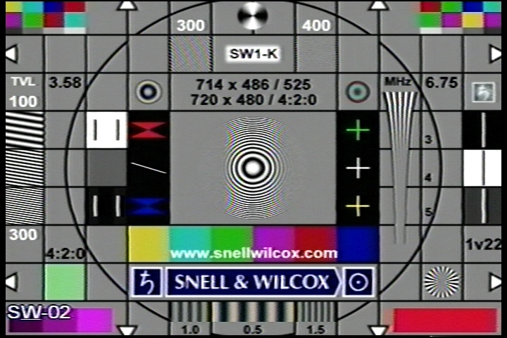

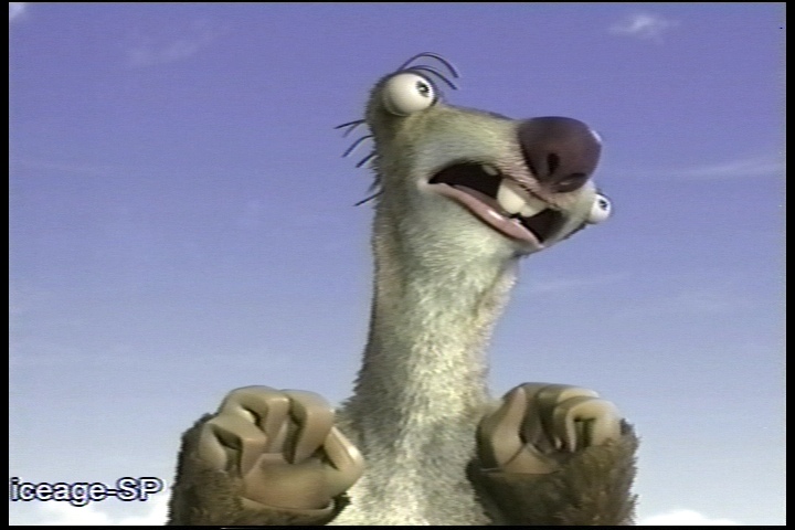

    OK, here are the caps with my Toshiba M-784
    Toshiba M784 - DNR "on"
    I think Fulci's capturing with the DVD recorder is causing some of the chroma issues and perhaps some softness. These caps have some of the chroma issues because of the composite connections, but not as bad as what Fulci's looked like.

    Originally Posted by Lou71
    @ BrainStorm69
    Is there any chance you might be able to upload that file again, The link has expired.
    Thank You
    Uploading again now. When it's complete, I'll come back and post the link.

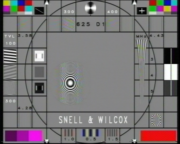

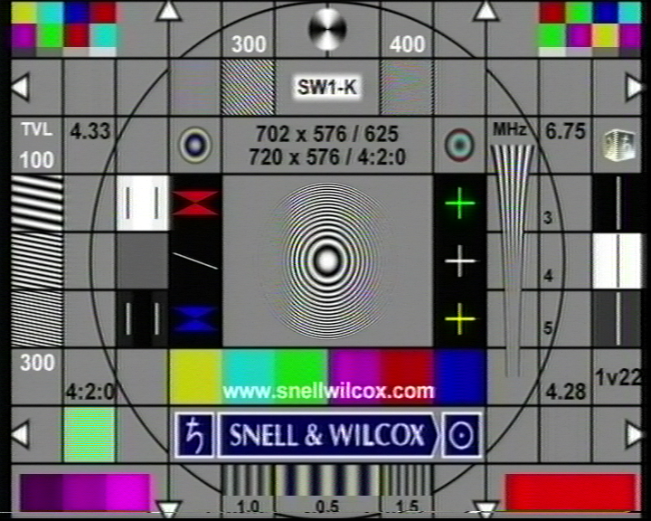

    For Pal users some caps from one of the last series of Panasonic high end vcr
    DVD Player: Redstar
    Connection used: S-video
    Cables: cable from Ati Vivo card
    Capture Device: ATI Theatre 550Pro
    Capture Format: AVI using Lagarith
    VCR for recording: Panasonic NV-HS860
    VHS Tape: TDK HDX PRO (VHS tape, high definition extra)
    VCR for playing: Panasonic NV-HS860 (Auto sharpness, TBC = ON, 3DNR = ON)
    Screen caps application: VDub save as png

    Soft setting for the next two:
    Impressive. This first image appears to have 3.2 megahertz of bandwidth! That translates to ~255 lines of horizontal resolution (per picture height).
