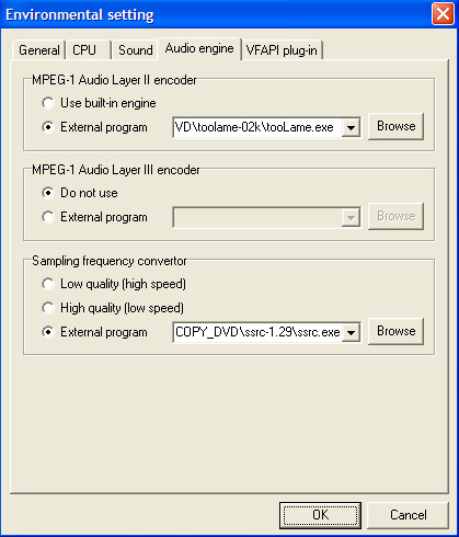

    Not sure why the error BUT please note that CCE does sound poorly plus you don't want MP2 audio anyways so it is best to use CCE for the video and use something else (like ffmpeg) for the audio ... which should be AC-3 format or PCM WAV but not MP2.
    If you did editing in you AVS script then you can run the script through TMPGEnc Plus in LPCM audio only mode (elementry stream) and it will spit out the edited PCM WAV file OR if you want MP2 it can do that as well. When doing MP2 with TMPGEnc Plus be sure to "farm it out" to SSRC and toolame.
    - John "FulciLives" Coleman
    P.S.
    Here is a pic of TMPGEnc Plus showing how to "set up" for SSRC and toolame.
