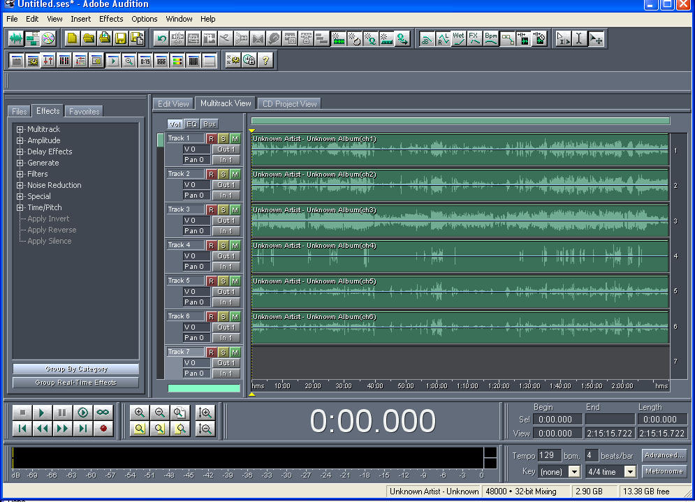

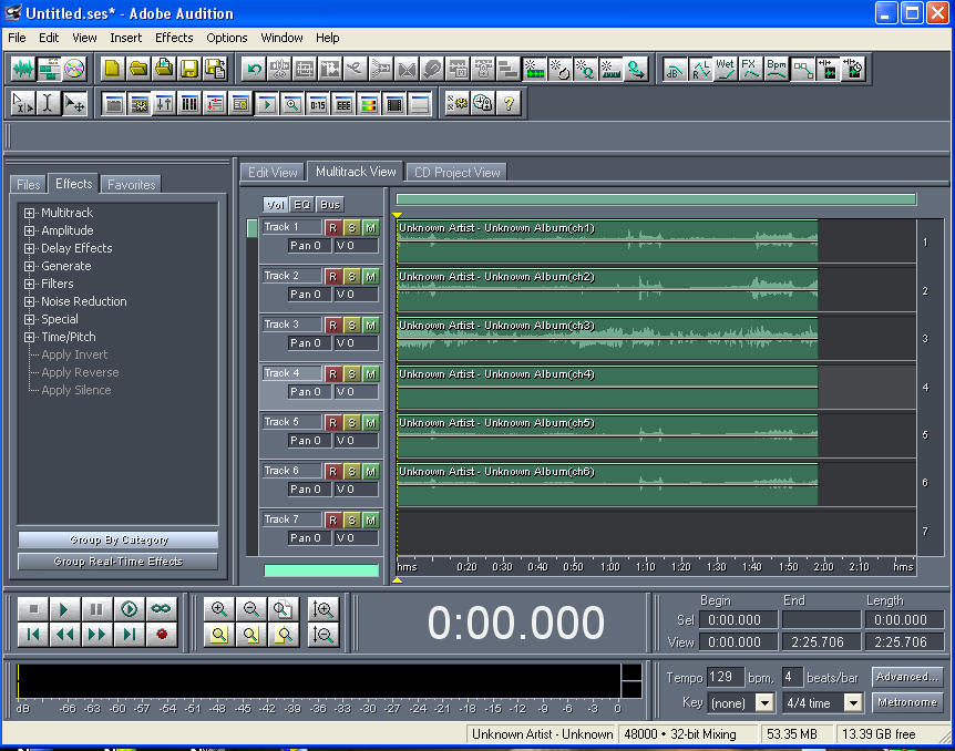

    Okay,
    Here is the screen shot if the entire soundtrack from ROTJ S.E.
    Here is the screen shot of just chapter 39
    The LFE channel is definately flat in that chapter and when i play it back through my PC system it is way banging!!
    But when i change to diff. channels, muting ones i don't want to hear, there is alot of bass being channeled from the center channel, prob. to give more depth and volume to the center channel to coincide with what is happening on the screen.
    So some of the bass from other channels must also be getting redirected to the subwoofer.
