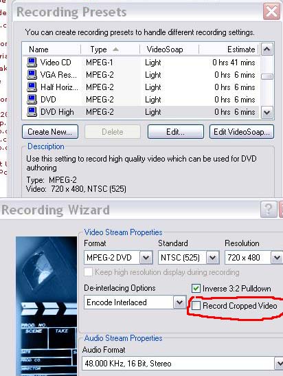

    Can also record cropped vid. in mmc

    Select crop in the MMC settings
