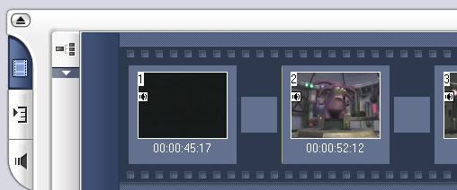

Now on the timeline , click on the second part , as the clip is now in two piece's .
Now repeat the previously mention step's and locate the "first frame" of the next clip , then hit
that scissor icon again .
You now have something like this

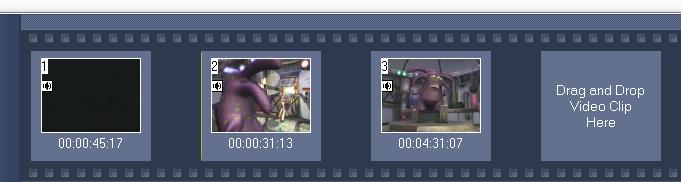

Should you be removing "ADD'S" , say in this example the middle one is a commercial .
Right click on the second video clip (our commercial) , and choose "delete" .
Repeat these step's to breakup the clip , or for those removing commercial's from content .

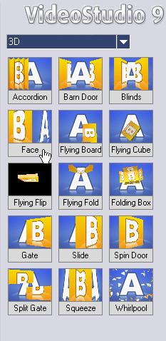

Now for filter's :
Click here
Now you see this
These little square's are where you drag you effect's to ...

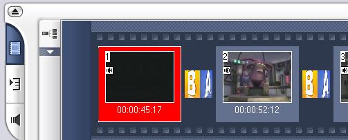

I have choosen "Face" and now add it to each of those little effect's box's .
Again , it's drag and drop .
You can use a mixture if you want ...
So here it is now .

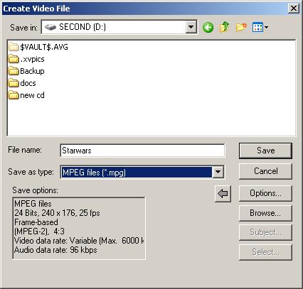

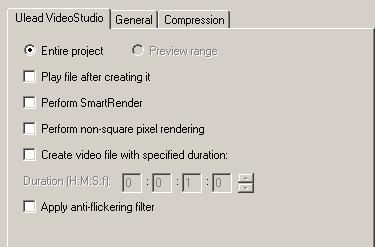

Now if done ... hit this
Here we have some option's , and I have chosen
Now I have chosen
Ok , these option's need adjustment

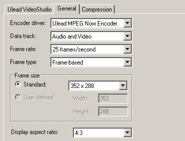

Hit "options"
It's 4:3 , so it dont get changed .
Just tricking the setting's for my need's for ifoedit later .
Hit "ok" , and start , wait till done .
