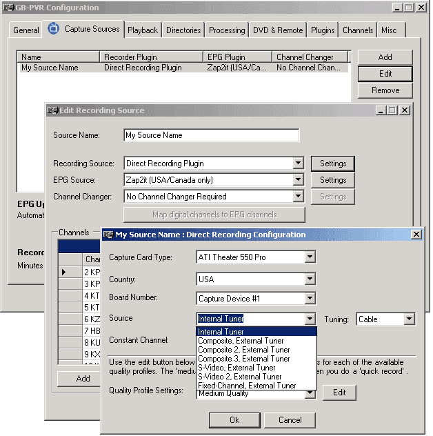

Does anyone know of any 3rd party pvr's (freeware, shareware or whatever) that allows you to pre-program svideo in for the MS Theater 550 Pro tuner ?
I Purchased a MSI Theater 550 Pro tuner, only to find out that the pvr does not work with the svideo in, it only works with coax.
I spent a fair chunk of change on this card, being told that a hardware capture card is better. only to find out that that the pvr only does coax. of course I'm really pissed off, and the place i bought it from is not the best for returning stuff.
I tried this freeware program called GB_PVR but i couldn't even configure it, nor did i see anything about svideo on there.
Thanks in advance for the info![]()

sorry it has taken so long. you can choose s-video input with gb-pvr. You need to go to GB-PVR Configuration utility. then go to the Capture Sources Tab. Pick your source and then click the Edit button.
It will then open the edit recording source window. Click on the Settings Button beside the Recording Source Field. Mine is set to "Direct Recording Plugin".
The Config window will open and you can select the source here. See attached image.
