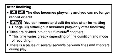

    Why do you say the ES20 does not do auto chapters? The manual describes auto chapters exactly the same as in the ES10. The manual is at the link below. The auto chapters are described on page 31.
    http://service.us.panasonic.com/OPERMANPDF/DMRES20.PDF
    Here is the excerpt,
