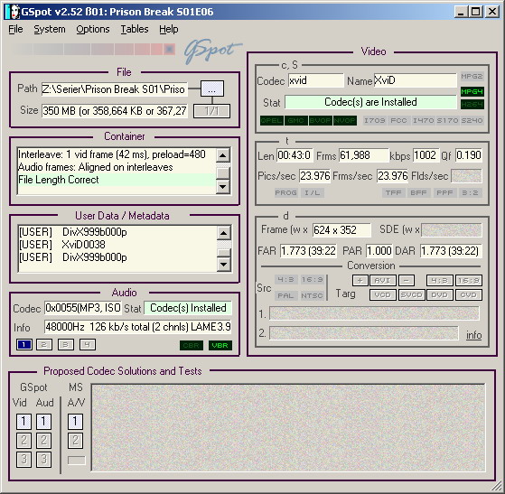

This is what it says under "properties" when I playback the file in Mediaplayer Classic :Video: XVID 624x352 23.98fps 997Kbps
Audio: MPEG Audio Layer 3 48000Hz stereo 130Kbps
Unknown
So is this the bad audio you where talking about?? The VBR MP3? -
You have to use GSpot to get the exact details of your source file. Post a screen shot. (From GSpot)
/Mats -
