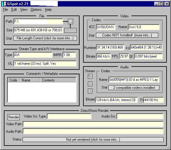

    Feb 2002
    Here it is
  9. Always Watching guns1inger's Avatar
    Apr 2004
    Miskatonic U
    Do you have a divx codec installed ?
    Can you load the avi in windows media player ?
    Also, I would update g-spot to the latest version (2.52 beta). It will make life easier down the track.

    Feb 2002
    Hi,
    I don't think I have the codec installed. I will do that. However, my Windows Media Player plays the file, a little slow but watchable.
    Feb 2002
    Thanks everyone
    I installed the codec and am now able to use VirtualDub for my AVI files.
