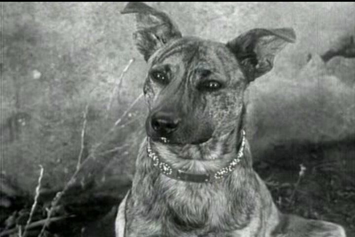

  9. I hate to drag this silly thread out longer than it already is, but I have to make an amendment to my earlier post in which I said the best way to get a lot of video on one disc was with TMPGEnc. I've been fooling around with WinDVD Creator, and while it sucks for any application needing variable settings, it's the absolute greatest if you really feel the need to get as much video as possible on one disc.
    As I stated earlier, I like to make long discs out of the old westerns downloaded from www.archive.org. I took one of these downloaded films and played around with it in WinDvd Creator. After saving the maximum amount of space by stripping the audio and converting to ac3, I then encoded the movie in DVD Creator at its "EP" mode setting. I then demuxed that (as DVD Creator only creates mpgs, and I wanted to remove the useless audio track), combined the resulting m2v with my ac3 audio, and got a beautiful copy of an hour long movie that's only 705 Meg. And it case you think that would have to look like crap, here's a screen. You'll notice very little blockiness, and it looks just as good in motion as it does as a still.

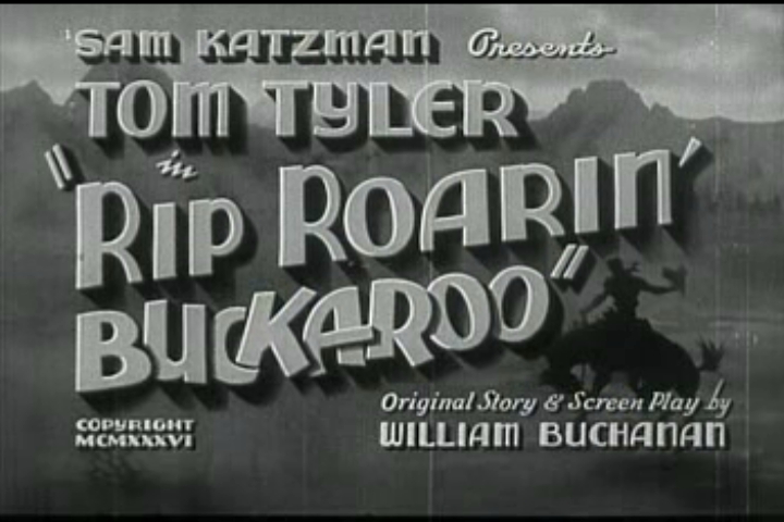

  13. The movie began life as a 3.5 gig mpeg. I realize the original question in this thread was how to encode AVI to 6 hour dvd, but it soon became about whether or not you could get that much of anything on a disc with any watchable quality. I've also done some avi with this method, and the results depend largely on the quality of the original avi. A good, clean avi should do just fine, but some avi files can be a little noisy to begin with and might not have as far to descend before they get problematic.
    Anyway, some more Buckaroo:
