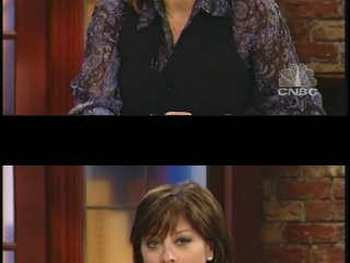

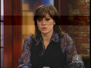

You mean a light or dark bar that moves up or down the picture, not that the entire picture is rotating, right? For example, something like:Originally Posted by hayabusa
this:
not this:
like the first picture yes
but not that much it's just 2 or 3 lines coming up ....& it's GRRR I get fixed to that problem too easyly
