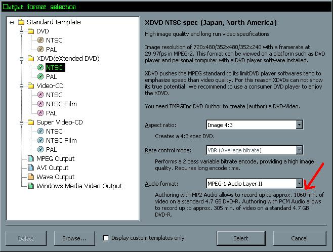

It probably won't look too hot, but you could try using TMPGEnc XPress's XDVD option.

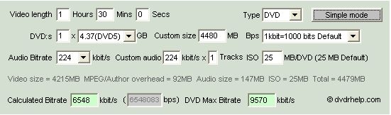

2. Use a low bitrate. How low depends on how long the totla running time is. Use a bitrate calculator to work this out.

Then use TMPGEnc DVD Author to build DVD Movie (about 4,6..GB)..to hard disk.

There is a nice bitrate calculator here ---> CLICK HEREOriginally Posted by RichieF
It is simple to use.
- John "FulciLives" Coleman
P.S.
The bitrate calculator only gives you a default overhead of 25MB when using the DVD "template". I would make it more like 200MB to 250MB to ensure that you really do have enough overhead for the authoring stage. Other than that the bitrate calculator works well."The eyes are the first thing that you have to destroy ... because they have seen too many bad things" - Lucio Fulci

You didn't look very close at that page did youOriginally Posted by RichieF
It is a JAVA APPLET meaning you can use it on that website. Just fill in the figures you want etc.
You can also download it and use it on your computer for when you are not connected to the internet. There is a link there on that page for the download.
