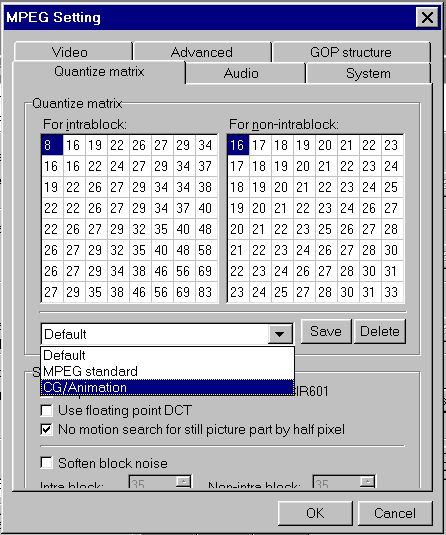

  1. Guys I am trying to setup some cartoon AVIs for dvd. I believe I am gonna end up using TMPEnc for the final conversion. I would like as little pixelation or quantization(not sure what u call it but im talkin about the little blocks that show up). I am just wondering what would be ideal to use for bitrate, should I use CBR, VBR, or what, and lastly should I do anything with the quantize matrix? Thanks for any input!

    In general, use the animation/CG QM should do quite well. VBR 2-pass will give you the best quality, at least for the video. There should be a preset for the QM, at least.

  4. "In general, use the animation/CG QM"-what is that? where do I find it?

    You DID say you're going to use TMPGEnc, right?
    [ing]TMPGEnc01.jpg[/img]
    If in doubt, Google it.
