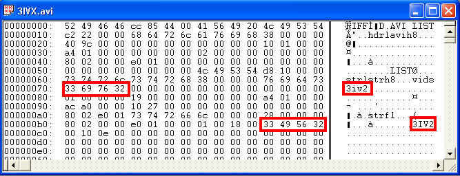

    It sounds like your file wasn't an AVI file since you didn't see a normal fourcc code (always text like XVID, DIVX, 3IV2, etc). In those cases it's easy to change the fourcc back (if you remember what the original was).
    The beginning of video files (where the fourcc code of AVI files is) is often nearly identical for a given file type. If you have a similar video you can try using a hex editor to copy the values from that file to the bad one.
    Here's a 3IVX AVI file with the fourcc codes marked:
    Every AVI file I've seen has the fourcc code in exactly the same place. Those are the locations that FourCC Changer changes. If you have similar intact file you could try restoring those 8 bytes in the bad file.
