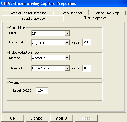

  8. A big thanks for all the help im receiving on this
    hlr,
    The brightness, contrast, proc amp settings have always worked for me but the comb filters and noise reduction filters (23 settings in total) do not work on any software, and that includes all the software discussed in this thread.
    Can anyone confirm that they can change the comb filters, noise reduction filters and actually notice a difference ?
    shs,
    The new mmc's offer less control over the cards features than graphedit.
    This pic shows the filters I want to play with:

  9. Originally Posted by aiw9800proman
    I tried all the settings at the max (putting 99 on all the boxes), and couldn't see any difference... .
  10. Yep, me too.
    Ive tried every combination of numbers and settings that it will allow me to enter into the boxes. Also tried all of them on comp, svhs, aerial and catv through both avi and mpeg.
    Me thinks they are all disabled.
    What we need is an ati rep to pop in and say "hey, dont worry because all these features wil be enabled in the next driver update"
    I used to be indecisive but now I just cant make my mind up.
  11. This is one weird card !
    My tests in graphedit have concluded the following :
    The filters perform some sort of "auto filter" for the preview (which is non adjustable) and shut off completely for the capture (which is nonsensical).
    I really hope ati release a driver update to fix this rather annoying flaw.

    Oct 2002
    I have captured quite successfully with DVD MovieFactory 2.0. I have been able to change the filters. The ones you showed a picture of. (I only just changed them to see if I actually could, and I could) I have been very happy with the quality of the capture, so I haven't really messed with the filters. Visually identical to straight input from the tape (Hi-8/s-video). However, your selection of resolution and bitrates are limited. I just use 8000 CBR. But you can select capture fields and motion search can be cranked. I know it's an older program, but it was the only one I could find that worked at all, until mmc 9.13 came out. I only use dvdmf 2.0 to capture then I exit the program. Christv worked as well, and I think you can adjust those filters you mentioned but it costs $50, and I already owned movie factory
    Brent
    I know the changing the filters has some effect on capturing in virtualdub because I was capturing a source and it was producing a weird sort of ghosting effect. after asking about it here someone said it sounded like a luminance issue. I went into the filters shown above and set everything to zero and capped again. I no longer had the weird effects. nothing else was changed.
  14. Final update:
    Sapphire have finally responded with this "the filters dont work with graphedit" I waited 3 weeks for that reply !
    Ati have responded with "As we dont support graph edit can we suggest you goto rage3d forums to get this sorted" at least they have suggested a forum worth visiting, but both companies have completely missed my main question - "do the filters work at all, are they available in the u.k., are they supposed to be adjustable in any way".
    My own extensive, exhausting and timewasting tests have prooved the following for my card :
    The filters are non adjustable in any program.
    The filters do appear to perform some sort of cean up for preview mode.
    The filters are completely non-existent in capture mode, difference is visible on screen with graphedit showing both preview and capture simultaneously.
    These are my last words on this subject, I am returning the card and possibly returning the pinnacle card I purchased today to replace it !
