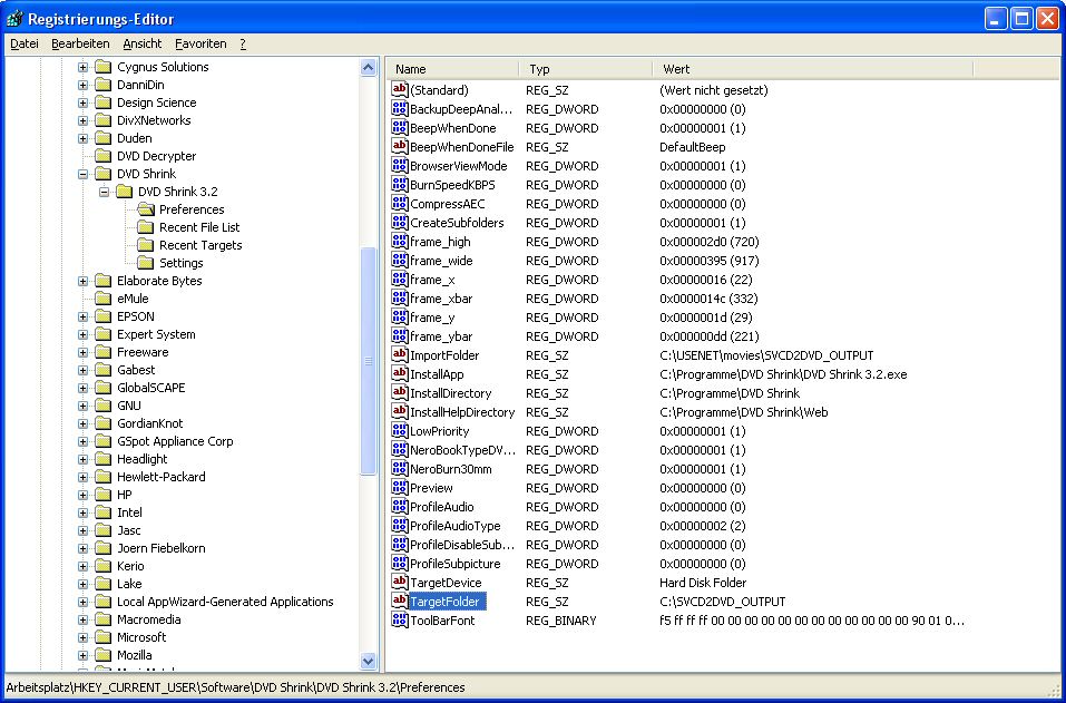

What is the path to your DVDShrink?
Also can you confirm you have the following registry key:
HKEY_CURRENT_USER\Software\DVD Shrink\DVD Shrink 3.2\Preferences
And can you tell me if you have the following strings in there:
CreateSubfolders
InstallApp
TargetDevice
TargetFolderSVCD2DVD v2.5, AVI/MPEG/HDTV/AviSynth/h264->DVD, PAL->NTSC conversion.
the folder i have installed DVD shrink is
C:\Programme\DVD Shrink
i have the strings in the RegKey.
i have added a picture of the regKey
regdvdshrink.jpg -
Well that all looks good. Can you email me & I will send you a debug build so that we can try to get to the bottom of this?

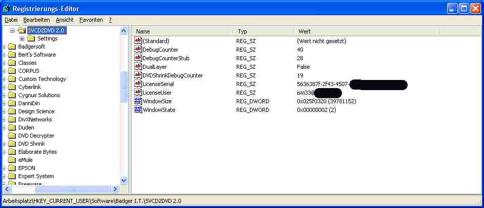

What is the DVDShrinkDebugCounter value in the registry?
No. It is a different error to the last one. Do you it everytime?

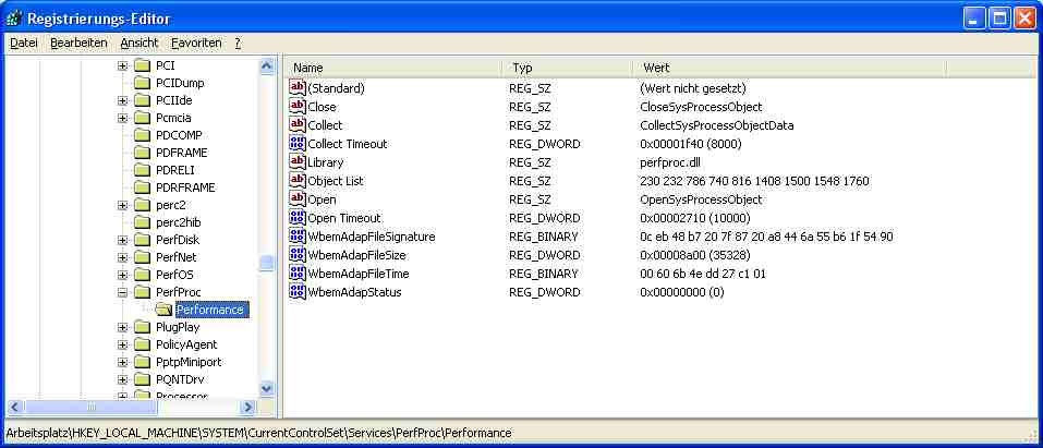

Do you have the rollowing registry key:
HKEY_LOCAL_MACHINE\SYSTEM\CurrentControlSet\Servic es\PerfProc\Performance\Disable Performance Counters
if so what is the value?SVCD2DVD v2.5, AVI/MPEG/HDTV/AviSynth/h264->DVD, PAL->NTSC conversion.
No - it is good that you don't have it! What about the other? Are you an administrator of the PC?
