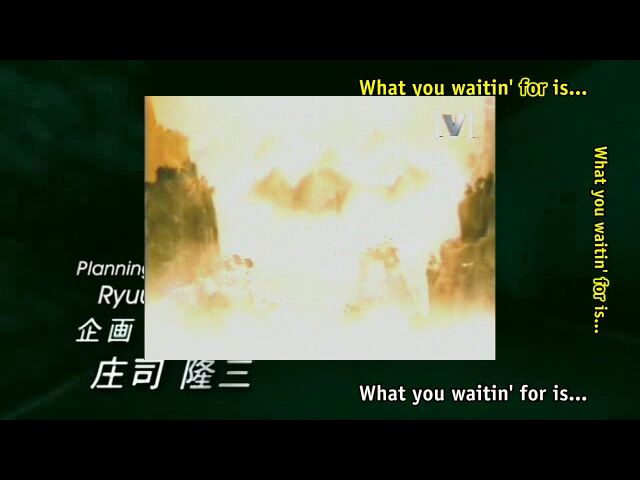

I kinda got Layer to work, I'll post a test clip in a little while.
Well, it's not EASY to AVISynth, but it's doable.
The script would look like this
And the output looks like this:Code:# Created by AVSEdit a=DirectShowSource("clip_a.avi", fps=29.97, convertfps=true) #352x288 Music Video clip b=DirectShowSource("clip_b.avi", fps=29.97, convertfps=true) #640x480 Anime test clip Layer(b,a,"add",255,144,96,0,true)
Two clips, each moving indepedently. However, the sound is from the clip in the BAKCGROUND, not the foreground.
I did a 30 sec test clip just for the heck of it. It works great. But it's like 7 megs so I can't post them here. Here's a link to Putfile.com...
So you have to do a couple things...
1) Create the background clip based on how many pictures you have, and add any transitions you want. between pictures. Hopefully same length as the foreground clip.
2) Take the sound off the foreground mix, and mix it into this background clip you created.
3) Use it with the code above, and let VDub make final output clip. -
