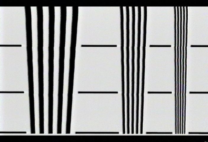

    Source: Old PAL VHS with strong timebase errors
    Player: JVC HR-S7600, B.E.S.T. ON, Edit Mode, Digital 3R On
    Recorder: JVC DR-MH300
    Digital8 Cam: Sony DCR-TRV110E
    Cables: Profigold S-VIDEO
    1st video: JVC's TBC OFF
    2nd video: JVC's TBC OFF pass-through on a Panasonic ES10
    3rd video: JVC's TBC ON
    4th video: JVC's TBC OFF -> Digital8 Dub
  7. definately go for the JVC with the TBC on.
    full frame internal TBC is always best and gives you superior results.
    Apr 2005
    Hungary
    The Digital8 cam's TBC give better results.

    I have to question why you would wanna do such tests. The best transfer would be TBC/DNR on, all the way. Also, I would suggest trying out Acoustic Research PRO II series cables. They keep the detail without the grain, but improved color and clarity.

    Ok. I realize that this discussion may have run its course some what, but there is still room
    for at least one more idea or thought, not yet fully realized then and/or now.. but thanks to
    this other topic (seen below) this thread came back to light, and I'm remember some of the
    details and the thoughts that came to me back then, and now.
    --> TBC Help - Worse results with than without?!?
    I'm mearly curious about something that cought my eye back then, but I either had little
    time or coudn't get my energies raised enough to bother. Anyway.
    One of the curious notions I was on about..
    Ok. First I wanted to note something that cought my eye while re-visiting that thread, and
    then touch on an idea/thought that seem to have resurfaced, today.. though again, thanks
    to that above (and this) thread
    So the 1st thing I want to note is this..
    One thing that cought my eye in those pictorial demonstrations were the TBC's performance
    as evidensed in the images bottom scanline, otherwise known as the vhs sync pulse or
    something -- I forget the terminology. Anyway.
    When you look at the bottom of those sync pulses, take notice of how thick they are and
    how some of them contain space between them.
    Q: So what is my point in all this ??
    Well, consider the issue with the vhs sample image of a known issue, 'flagging', or sometimes
    termed, 'curling'.., however, both are the same. I mentioned to lordsmurf (in the other
    thread) that in one of my prev encounters with flagging/curling of the top portions of a videos
    image, that I finally resolved that issue by using my ADVC-100 unit. My assumption was the
    term, sync pulses, in that thread, that cured this issue with flagging. And because it was
    mentined that a Panasonic ES10 was also used to cure or eliminate this issue, I had assume
    that between these two unit devices, that they might have something in common or in relation
    to one another, built into each'es hardware, and that it might be best that we determine what
    exactly is it and what is causing it, so that we might be able to put an definate lable to it and
    point a proper suggested remedy for future reference sake. But if we can determine what it is,
    excactly in each of these hardware, we might be able to decirn the proper terminology for this,
    and guidance.
    (ok.. my eyes are weighing heavily. So if you see too much toypos, its getting late for me,
    whci is wareing out for me energy levels -- sorry)
    The 2nd thing I want to note is this..
    The clue to all of this and to some extent is in the way the sync pulse is written down at the
    bottom on those images, where you see that gray/white line, which is usulally about 5 pixels
    high, give or take. The clue, as far as telling what might cure an issue with flagging is in the
    way that sync pulse is written to tape in terms of how many lines are written or thick they
    are. If you see a gap or space in the lines, then its a good indication that your device has
    a certain TBC function. And that function might be the clue that it contain a de-flagger
    feature. Thats my name for it. But you can call it what it really is if you know what the
    proper term is. That is what we (I am) after, here.
    So, if you see a spacer or gap inbetween that sync pulse line, then that is your indicator that
    your equipment has such a valuable feature, a de-flagger. And you can lable that in your
    tools reputuare -- and say, 'use this, it will remove that flagging' or something like that.
    <<EDIT:>>
    I do know that my TRV-22 dv cam has this same exact space/gap inside the lines when the
    source is from a vhs tape. And, I should re-test my ADVC-100 (suing the same source tape,
    'jeepers creepers') movie as the soruce gauge, and report back here, my findings, in hope
    that it helps to give weight to my idea or theory. Yes, that is a great idea. I'll try and run
    it, tomorrow evening, after work.[/<<EDIT>>]
    My next item on the list, I will follow-up in another post, here. But my energy levels are running
    very low, and my eyes are weight to heavily. Maybe tomorrow, I'll post it. Tune in, for theres
    still more work to be done, and more fun ... ... .

    Originally Posted by BrainStorm69
    Toshiba No TBC
    JVC no internal TBC

    I actually have a lot of technical detail on recorders made from 2000 to 2007. Also several from 2008 to 2010. Certain RCA models used Zoran, too, and looked just as good as Toshiba units. I have one. But without IRE problems found on Toshiba decks! (Though there were still no clean-up filters -- grain NR, chroma NR, etc -- as found in LSI Logic chips.)
    @NY2LA (2010 post), all of the issues you describe are due to lack of TBC and/or hardware processing.

    It's a low-end mediocre-quality device. That's all it is.
    A TBC, at minimum, would help.
