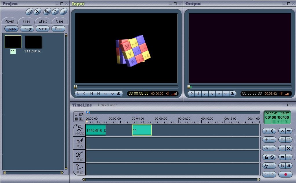

    pchan....I've never used this Womble program before and I can't even figure out how to delete a segment, and I can't press the record button because it's not lit up...what am I doing wrong, is there a faq on this program...I tried the help but it didn't help.

    Go here and download the pdf manual..(PDF manual for MPEG Video Wizard)
    http://www.mpegvideowizard.com/mvw/mvw.pdf
    TYou can only trim on left and right end. Once you have finished trimming, just drag and drop the trimmed clip from Input screen back to your Video folder. Right-click to close clip on your Input screen. Drag & drop your .VRO to the Input and continue to trim your next segment. Once, you are done, just drag and drop your trimmed clips on the timeline. You can leave 6 seconds gap and drop in some nice transition provided. Press the RED button.
