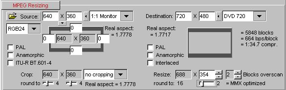

    Nov 2002
    Hmmm... guns1inger... Played with FitCD a little bit more, it's definitely those small sliders that did me in. By playing with the destination "round to" slider to 2 (overscan to 0), I get this script instead
    # -= AviSynth v2.5.6.0 script by FitCD v1.2.8 =-
    AVISource("SomeVideo.avi")
    BicubicResize(480,370,1/3,1/3,0,0,640,360)
    AddBorders(0,48,0,62)
    But as you can see, the resixing is... to 480x370, while the source was 640x360, which brings up 2 questions...
    1) I thought it's faster to resize in only one dimension than 2, esp. when the difference is so small?
    2) Even according to DJRumpy's guide table 1, the conversion should be to 480x360, then have 60/60 border added. So where did 370 + 48/62 came from?
    A guess on where 48/62 came from... 60 is a multiple of 4, just not an EVEN multiple (4x15=60). So to make them EVEN multiples of 4, they can be slightly shifted to 64/56 (4x16/4x14) or vice versa. I guess that's the rationale to push them from the ideal even border?

    Note that on the highlighted field, it is NOT possible to pick 4:3 or 16:9. Closest I can get is that DVD one, which produced the output on the right, which is, needless to say, completely... useless.
    There is no 4:3 or 16:9 on a PC for source video. FitCD covers all the possibilities in it's drop down list. Example : unless an avi file has non-square pixels, it will be 1:1 monitor. If it is SVCD, there is an svcd source. etc.
    Have a read of this page, especially the table at the end of the article. http://www.mir.com/DMG/aspect.html
    I cannot explain the weird calculation for the 370 resizing in FitCD. I have no interest in out dated formats such as VCD and SVCD, which is why my calculator only concerns itself with DVD resizing.

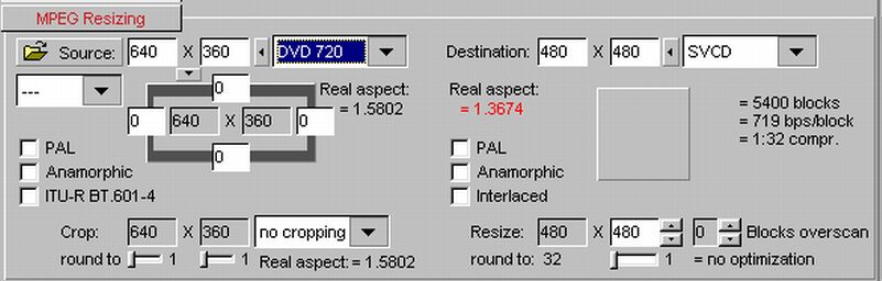

    Nov 2002
    Got it. We are ssuming PC pixels are square and thus aspect ratio is 1:1. In any case that didn't affect the calculations. It's that "round to" slider on the right that really changed things around.

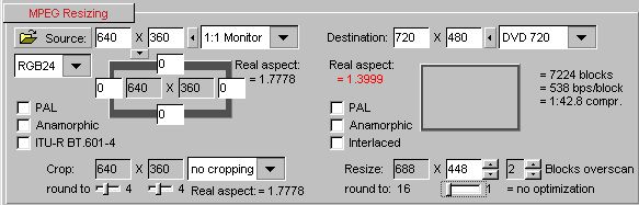

    Even with DVD 720 picked, it's STILL doing weird resolutions, and it's now definitely in the "optimization" slider under the output. Here are two screenshots for comparisons:
    So basically seems like "no optimization" (slider all the way to left) is broken. You have to leave the block optimization to at least 2 (second step) or 4 (third step) for the border calculations to work.

    Nov 2002
    Did a couple more tests, left it at 16. The script then look slike this:
    BicubicResize(320,176,1/3,1/3,0,0,640,360)
    AddBorders(16,32,16,32)
    But somehow, when I run this, this chopped off the bottom X pixels of my 640x360 picture, but as you can see, there is no trim statement. It's as if including them with 0 trim somehow defaulted it to trim X pixels off the bottom. If I replace that line with
    BicubicResize(320,176,1/3,1/3)
    Then there's no chopping at all. It's weird.
    And even stranger, the output looks horizontally compressed, both on the PC and on the burned VCD (the DVD player is set to 4:3 display). So the margins are WRONG!
    For a test, I changed the 2nd line so it's 16 all around. The code then becomes:
    BilinearResize(320,208)
    AddBorders(16,16,16,16)
    This then looks proper, both on the PC (in full screen, automatic letterbox) and on the DVD player/TV!
    What am I missing? What did I do wrong with FitCD? I'm getting really confused.

    kschang there's nothing broken about FitCD. You are using it incorrectly. The FAQ that comes with it isn't great but it does describe each of the settings. There's also tooltips if you hover over the features.
    You have cropping set to none. Any change anywhere is going to change the aspect ratio and give you errors since you are just resizing active picture, not cropping as well to maintain aspect ratio. Hover over the cropping option and it tells you this. "no cropping causes aspect-ratio error." Turning optimizations totally off works fine if you make sure you aren't screwing up your aspect ratio somewhere else. To keep aspect ratio perfect everytime you'd set rounding to 1, turn off optimizations, and turn off the overscan option, and of course you'd always have to have cropping of some kind set. But this isn't using the program to its full potential either. You're supposed to play with each of these options and give and take here and there to get the optimizations you want without straying too far from the source aspect ratio.
    Generally you should leave cropping at accurate, but you may have to adjust it depending on source and output settings. For round to you should try to never go higher than 2, but again adjust these as needed to maintain aspect ratio. 1 would of course be best, use 2 if you have to. You should always try to use the overscan option if you are going to be viewing it on a tv, but sometimes there's just no way to do this and maintain aspect ratio. Try to adjust the optimation roundign as high as you can without errors. Full mod16 optimazation speeds up encoding and increases quality. I love FitCD! But you've you got to adjust ALL of these settings each time to maintain aspect ratio.
    guns1inger: the blocks overscan option always has its benefits even when subs are not involved. If played on a tv the outer X number of pixels (depends on tv) will not be visible. Yet you still have to encode that picture meaning bits must be allocated. Setting the overscan option to 2, crops 2 pixels from all sides and adds black borders instead which require virtually no bits to store. That's a savings of roughly 8 pixels every single frame. Doesn't sound like much but over the course of a film you are talking about a decent increase in effective bitrate and of course when viewing it you'll never miss those pixels.

    Another observation... For source video of 640x360, with x and y round set to 2, no cropping yields 640x360, but accurate yields 624x360 (chopping off 16 pixels!) which makes no sense. FitCD seems to have a bit of math problem in this case.
    Overscan is now set to 2 blocks You mean the "macroblock optimization", right? The slider below the output side? Have that set to 16 for now, got the code as follows:
    BilinearResize(320,176,0,0,640,360)
    But again, this looks horizontally compressed. And FitCD complains that the error here in aspect ratio is about 7.6%.
    If I set the slider to MMX Optimization (4), I get this code instead:
    BilinearResize(320,164,0,0,640,360)
    AddBorders(16,32,16,44)
    Which makes even LESS sence this is even MORE vertically compressed (by additional 12 pixels, or 5% of vertical space!! Yet according to FitCD this one is MORE accurate... (less than 1% error). Logically this doesn't make sense.
    Don't mean to hijack guns1inger's conversation, but it's NOT efficient to rescale the whole picture just to save a couple pixels. The time spent to resize the full frame would more than offset the time saved encoding a few more black pixels. If you use crop then addborder without using resize, then yes, this would make sense. But resize, THEN add border to add overscan would NOT yield any time savings, logically speaking.

    Kschang, have you read the documentation that comes with FitCD? Its brief and you'd definitely have to read between the lines but I'm comparing it to your questions and it really does answer every one of them.
    Not if the source is exactly 640x360, which is 16:9, isn't it? In thise case, there is no difference between accurate vs. no cropping. Rounding was set to 4 / 4 on the left side.
    FitCD and I are generalizing. The point is that you are limited to resizing proportionally and then adding borders. Sometimes cropping is necessary to maintain aspect ratio, and it is almost always going to be necessary to implement the optimizations that FitCD offers. In your example, using accurate cropping allows you to achieve full macroblock optimization (every pixel fits in a macroblock with no left overs) without losing aspect ratio. No cropping does not.
    BTW: the round to option under cropping has no effect unless you actually have FitCD set to crop. You should always leave the round to option set to 2 except with interlaced sources in which case you should set the vertical rounding to 4. Otherwise adjust as necessary to maintain aspect ratio.
    There is no math problem. FitCD is giving you exactly what you are telling it to do. As the instructions state, accurate cropping attempts to retain as much of the film pixel resolution (active picture, not letterboxing) as possible yet still keep the aspect ratio accurate. If FitCD crops that much than that is simply how much must be cropped to maintain aspect ratio given YOUR input settings. As the instructions state, if you feel that too much is being cropped than you need to try a different cropping mode (you can choose to prioritize horizontal or vertical picture), change rounding, remove optimizations, turn off overscan cropping, manually input the amount to crop (by setting the resulting resolution after crop), or do any combination of these things. Doing so adjusts all other factors and gives you a real time answer as to whether aspect ratio is correct. You've got to play with it man.
    Look, if you just turn everything off (except cropping ) then FitCD will just give you a plain jane script to get to your target resolution. This is basically where you should start. From there you should always try to turn on the overscan option. You should try to get as many optimizations as you can. And the golden rule is that you should never get any noticable aspect ratio errors (% will turn yellow then red). If at any point FitCD loses aspect ratio or crops too much to warrant implementing the optimizations, then you have to back your settings down or modify their combination. In any case FitCD only gives you the script that you tell it you want, and reports the resulting aspect ratio.
    If I set the slider to MMX Optimization (4), I get...
    How are you eyeballing the aspect ratio? Are you just previewing the avisynth script in media player? If you are actually encoding to mpeg did you set the aspect ratio flag correctly? Are you testing it in a media player that parses aspect ratio flags (many will not unless you do the full blown authoring to DVD)?
    In order to understand what is happening you have to understand some fundamental basics of mpeg encoding. I bet you already know this but I don't think you are thinking in these terms when analyzing what FitCD is doing. FitCD is intended to be used to create scripts for use with mpeg encoding which uses aspect ratio flags. The target film pixel resolutions (actual picture) of all of the supported formats (VCD, SVCD, DVD, etc..) do not have 4:3 or 16:9 aspect ratios. Rather, the decoder resizes the output to these aspect ratios at playback. What you see on the tv is NOT what you will see if you just preview the avisynth script in media player. There is no aspect ratio flag set in this case.
    At least in your example, you are dealing with an avi file that has a perfect 16:9 aspect ratio. This is done because most of the conventional codecs do not support aspect ratio flag parsing. So your avi was either created, or edited, so as to be stored in the exact aspect ratio that it is to be viewed in. This is NEVER the case with mpeg based formats. So in transferring it to mpeg you've got to distort the image and then set the aspect ratio flags accordingly to have it properly formatted at playback. That's why it will appear that the aspect ratio is way off in any of the intermediary stages. The decoder is only showing you the film pixel resolution, it is not showing you the intended playback resolution which can only be achieved by setting aspect ratio flags and then having the decoder parse them.
    I can't even remember how many years I've been using FitCD (actually I use the full version Fit2disc which is only available by donating. Definitely recommend it!) I know shh has tweaked the hell out of this program and its been thoroughly bugtested by the community. I really feel very safe saying that if FitCD reports 0-1% aspect ratio error than you will indeed have proper aspect ratio when played back in the intended format. If you are seeing bizarre aspect ratios in the intermediary stages its because that is how it is supposed to look. This will be corrected at playback, and this is simply how mpeg based formats (ex: DVDs) work.
    gunsl1inger already touched on this but the overscan option is not to save encoding time, its to maximize bitrate usage. The rule is, don't encode what you don't see. The pixels that are cropped, and now replaced with black, are pixels that would be lost in the overscanned area on the tv anyway.
    But for that matter, no resizing is being done. The option crops and adds borders, that's it. Using this option actually should decrease encoding time minimally, but that's not its purpose.
  15. You want that 640x360 AVI resized the way you expected? Check the ITU-R BT.601-4 resizing box.

    Well, guess I'll have to take a picture of my TV to show you... But after trying a few things I figured out that my TV has MASSIVE overscan. It loses at least 16 pixels on both the left AND right side. Even after putting in 2 blocks of margins, my pictures STILL shows with no black on left and right. THAT could have thrown my perception off a bit.

    How do you lose resolution using the overscan option in a DVD to DVD backup? I don't understand. Either way the same number of pixels are used to display the image on the screen. (that which you actually see,) and the image has not been scaled in any direction. Or are you saying the overscan option just adds a border on the edges? I thought it cropped and then added the border.
    Yes the procedure is only useful assuming playback on something that overscans so its not for everyone but I do think its the best option for most people.
  19. Hi adam-
    I kind of hate to argue with you because I might have missed something (and for the same reason I'm hesitant about taking on guns1inger, who has corrected me on at least one occasion), but:
    Yes, that's what the blocks overscan does. It resizes the image down and then adds black around the smaller image.
    So ordinarily when reencoding a DVD source for DVD no resizing is done, but when using 2 blocks overscan, it'll give you this:
    LanczosResize(656,448)
    AddBorders(32,16,32,16)
    That's a significant loss of resolution in my opinion, not to mention the fact that resizing, no matter how well done, further degrades the image.

    I think I figured out my problem, and it's really a forehead slapper.
    My AVI is XVID encoded, which VDub can't read directly, but I was able to do a DShow through AVS and fed it in any way. Keep in mind that the AVI is 640x360.
    However, previewing the AVS with JUST the DirectShowSource line through VDUB shows that the resolution has suddenly became 640x480, with black borders added automaticlaly by SOMETHING!?!?!
    Undocumented behavior, AFAIK. I checked the AVISynth manual in AVSEdit, didn't see a thing mentioned that it would behave like that.
    So any resizing I did, I was squeezing extra black space into the top and bottom, NO WONDER it looks verticaly compressed!
    Now I am DEPRESSED. :P That's what completely threw off my calculations. :P
    You guys are right. There's nothing wrong with FitCD. My apologies for trying to suggest otherwise.
