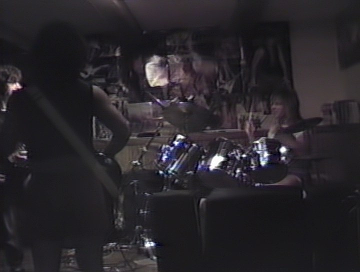

    I captured an old VHS tape and I'm wondering what I can do to clean it up. I understand a better VHS deck and TBC would certainly help with the switching noise and occasional sync problems, but I'm wondering about the other things seen in this quick clip.
    I'm using a Panny PV-1730 thru a DV camcorder into firewire and capturing with Premier Pro 1.5.
    Unfortunately the 20 second example below is about 85 meg, I wasn't sure how I could shrink the size without introducing issues that might be related to compression. Thanks for any ideas (and for taking the time to look at such a large file).
    (it's still uploading, give it 30 minutes or so)
    http://www.nema.com/junk/fragment.avi

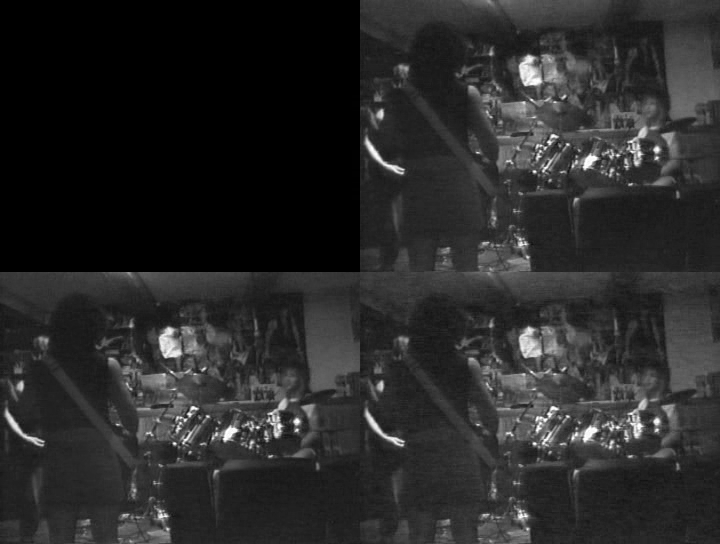

    Your actual transfer is fine. The image is pretty stable. The difficult part is trying to pull out any details from the scene. You've got a very dark image and a lot of noise in the color channels. Bringing up the brightness will expose all of the noise, as you can see here: (BTW, most of your noise is in the blue channel)
    Trying to reduce that much noise introduces a new set of problems - namely smearing, as noted below.

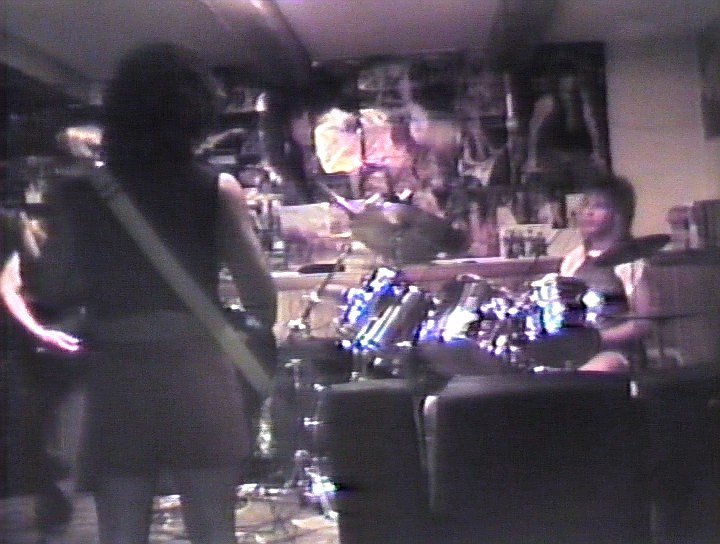

    And even when the brightness levels have been brought up, the cleaning still doesn't look very good.

    i've just tried a combo of jim casabury's 2d cleaner first then his temporal cleaner 2nd. the results are very interesting. the picture is MUCH cleaner, but there are now stationary figments. almost like you're watching the video through a dirty window, but it's only bad when there is a camera pan. it's distracting... but the video is SO much cleaner... did i mention that?
    new file is here, it's a little under 5 meg this time. am i heading in the right direction? any idea on how to 'wash my window'?
    http://www.nema.com/junk/fragment2.avi
    Dec 2005
    just replaced the sample i mentioned above, i think i'm about as close as i'm capable of at this point. i've played with contract and brightness as well and i haven't resulted in anything that looks better than the dark original.
