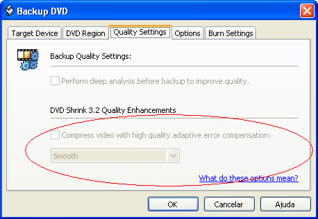

If you are using DVD Shrink 3.2, you can access tab "Quality Settings" after backup button, and then you can select the second option ("Compress video with high quality...). Under that option you will have 4 options. I usually select "Smooth", but you can try them.Originally Posted by vampirexxi

thanks for the pic of the quality settings.
