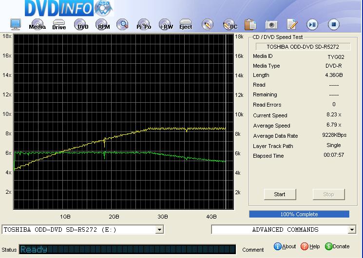

It sounds like a media problem. I would do the following test. Copy a known good video to that disk then test with DVDInfoPro.
Here is one result I got from poor, faked TY media. Notice the speed glitches. On playback, the video stutters at those places.
