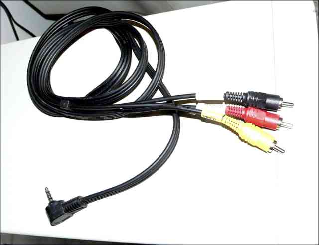

    I just connect from video out on VCR to camera.
    This is what the cable looks like
    "Whenever I need to "get away,'' I just get away in my mind. I go to my imaginary spot, where the beach is perfect and the water is perfect and the weather is perfect. The only bad thing there are the flies. They're terrible!" Jack Handey

    You will need to have something that takes a signal out from the VCR.
    Have you looked at the picture I posted? Is there anything on your VCR that you could fit those AV cables into? It would help us all if you described ALL the in and out plugs on your VCR, because at the moment I'm just guessing.
