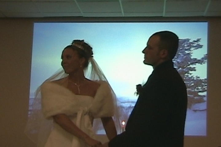

I'm working on editing some shoddiness out of a few of the clips from my brothers wedding and would like some input on this here scenario, if anyone has the time.
Problem: During the ceremony the camera person unfortunately did not take the time to correct a problem with the tripod, resulting in an oblique camera angle that just looks shi**y and is shown in this picture right here:

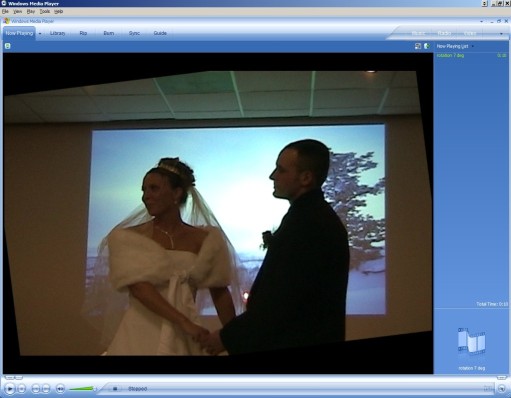

It's not the end of the world, but obviously not ideal and so I tried doing some correcting with V-Dub's rotation2 filter set to 2x2, bilinear. Results were as expected but, for some odd reason, look better (to me, at least) when shown in Window$ Media Player than in a "normal" player capable of doing a bit more with aspect ratios - like Power DVD. Pictures will offer a better explanation than words can provide, so here they are. First, Windows Media Player:

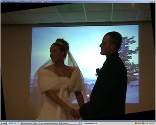

And then Power DVD:
Notice here that the backlight is now straight which, IMHO, damn sure looks better than the other one. More importantly, however, see how WMP shapes the display field into sort of a rhomboidal shape? This is again not perfect by any means but, to me at least, it certainly looks a little bit better (artsy, even?)than the lopped off and turned-on-its-side square that Power DVD is displaying. Past experience tells me that what Power DVD is displaying is what I'm going to get in terms of a final DVD product, assuming I leave it the way it is now. And so my questions are:

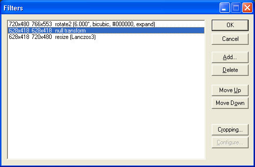

Most of the angled black border will be hidden by overscan when watched on TV. Try burning to a DVD and taking a look.

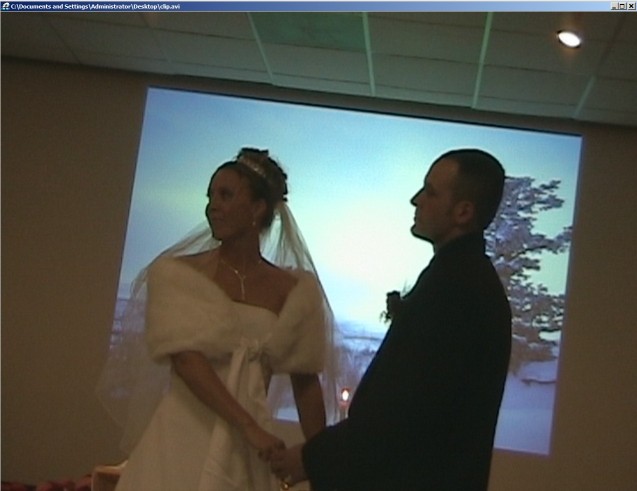

You'll have to rotate, crop, and resize to get a final result like in my picture. Obviously you'll have to handle this scene differently than others in the video but if your final result is the same frame size as the rest of the footage you won't have any trouble integrating it.
Here's the filter sequence I used in VirtualDubMPEG2:
The Null Transform is there just for cropping.
Note that I took one of the images you posted and resized it to 720x480 assuming that is what it started out as. -

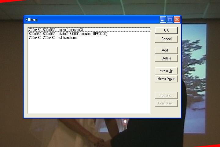

Here's an alternate filter sequence:
I enlarged the image first to 800x534, rotated by 6 degrees without the "expand frame to fit" option, then cropped back down to 720x480. A small amount of the background is still visible (I used bright red as the fill color to make it more obvious.) in the corners but you won't see this on TV.
The Null Transform filter does nothing -- it's there simply for cropping. VirtualDub's cropping has to be attached to a filter.
